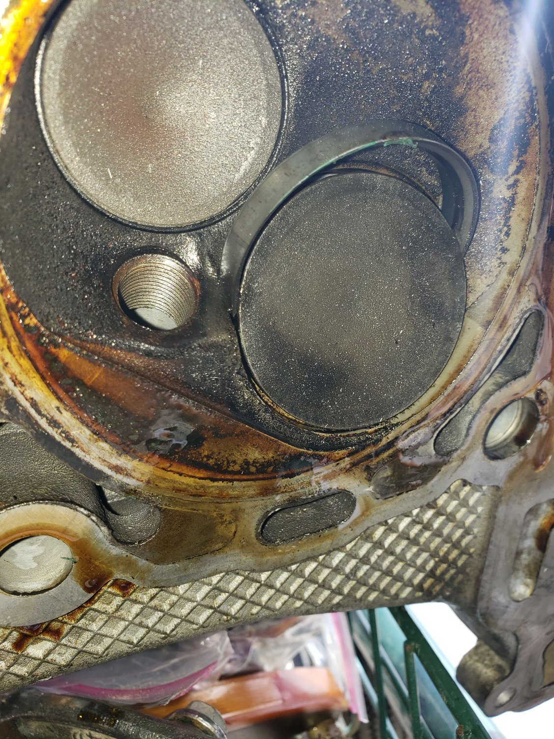

Actually the HG was fine....Cylinder #2 dropped a valve seat...no rhyme or reason to it...got up on Saturday morning, drove about 5 miles to Costco for fuel, drove another 3 miles to the chiropractor, came out 20 minutes or so later and poof....valve seat gone...and the rocker arm was also off and in the head just chilling....
the dreaded dropped valve seat....
Thankfully the piston just had "minor" markings from contact...
I tell you this project has me more worried than a long tailed cat in a room full of rocking chairs...This is probably the biggest repair I have attempted on my own...previous engine rebuilds (way back in the 80's on Ford and Chevy truck motors) was always done with my uncle, dad and or grandfather...but with all the help I'm getting on this board...I'm doing it
