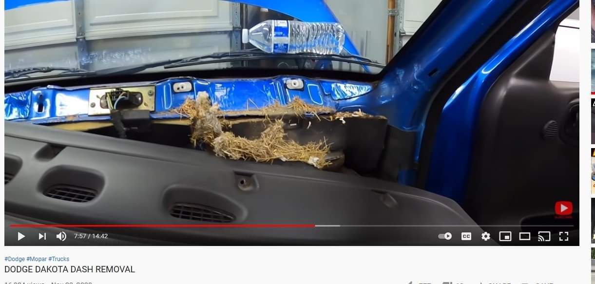

Location snipped from youtube video of a 2000 Dakota...this is where the resistor is on the inside of the vehicle
How i accessed the resistor...note not my Durango it was from the web on a Durango with a 5.9L

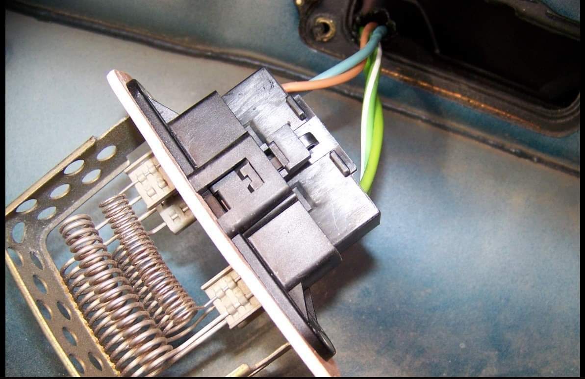

The damn resistor

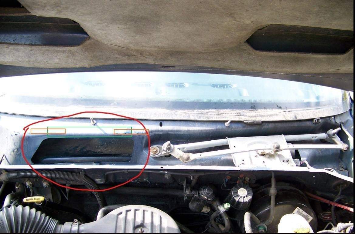

Plan on how I'm going to open the access point. I'll cut the green area, make my repair, then seal the edges with metal duct tape and add a piece of flat bar as shown in the orange and put 2 self tapping screws on each side of the cut piece
Just not enough room to get adult sized hands and arms in to get the plug off. So I'm not really close to the heater box.
