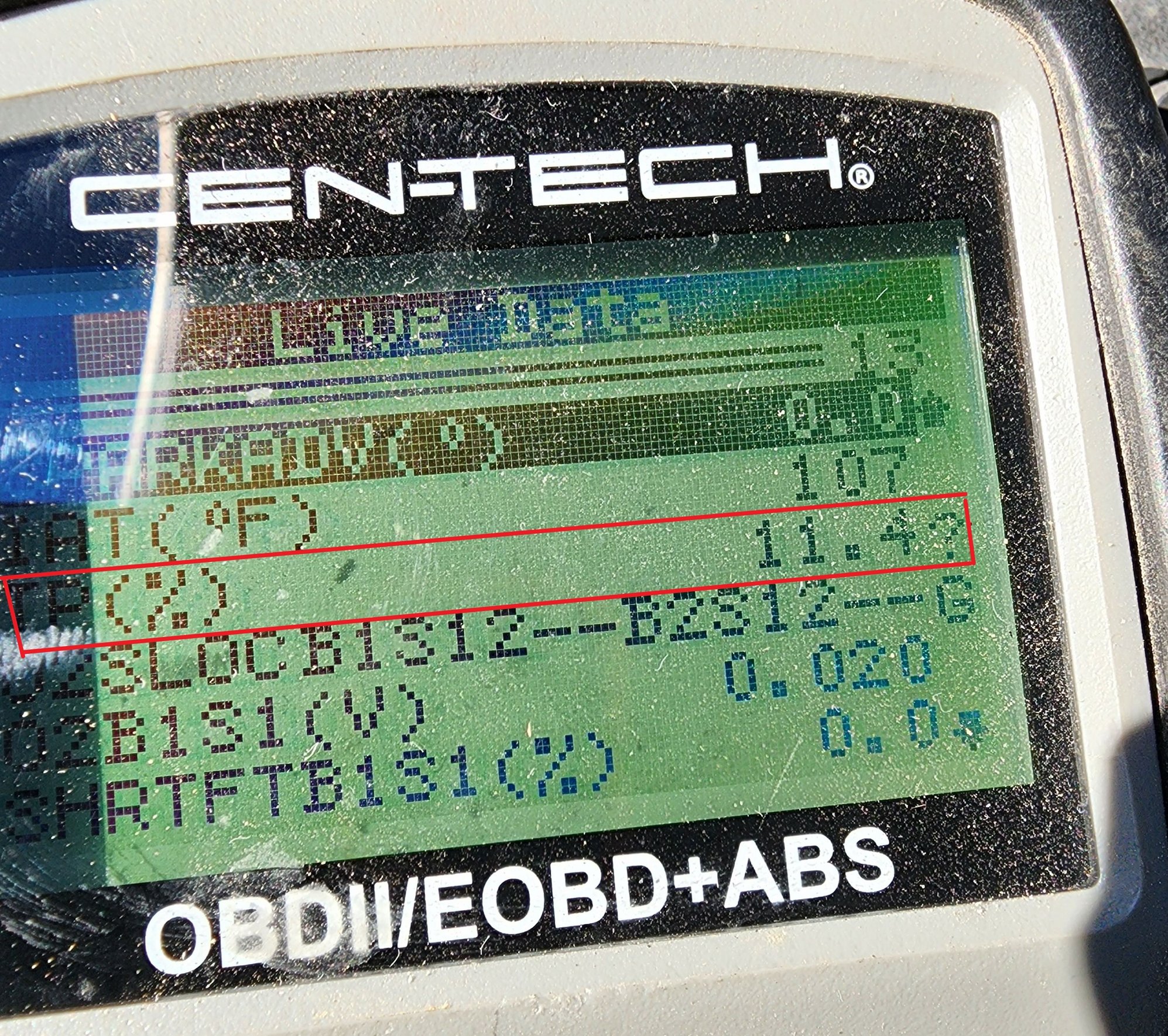

So another TPS related question about the high idle. It hasn't come back (thankfully) but I did notice something a bit odd when I was trying to diagnose the issue. I have a Harbor Freight Cen-Tech OBD II reader similar to the Autel reader pictured below:

Anyways on to my question, When I looked at my OBD II reader, the live data showed (with the engine OFF) the TPS @ 11.4% at IDLE and 76.1% at FULL THROTTLE. The same test with the engine running showed idle at 11.4% and no I did not try and redline it to see if the 76.1% was constant.
OBD II Live data (engine off) TPS reading 11.4% at wide open throttle
OBD II Live data (engine off) TPS reading 76.1% at wide open throttle
So I thought it may be just how the 4.7L engines act...I tried it out on my dad's 2006 Ram 3500 diesel (yeah I know apples and oranges but it was something to at least check) and found his went 0-100%. Is this something that needs to be "tuned" to achieve proper/correct readings for 0-100% on the Durangos or is it basically doing what its supposed to??

I pay more attention to the throttle blade itself. If it is all the way closed at idle, and all the way open with the pedal on the floor, yer good. PCM will figure out what 'relative' throttle position is by airflow, more than what the tps is telling it. TPS just gives the PCM a general idea in how hard you want to accelerate. So, it's all good.
