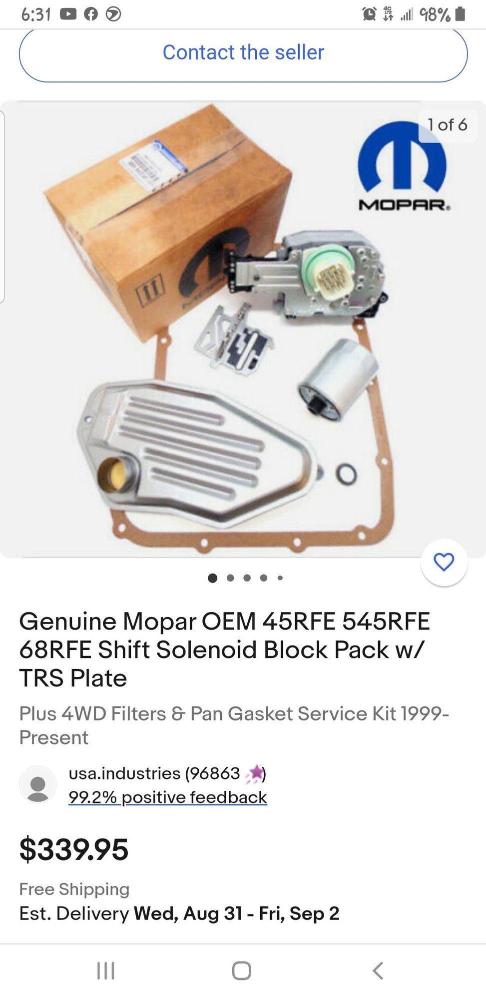

Ya im in the process of servicing it. I did some research and maybe you guys know more but apparently the shift solenoids or the solenoid control unit goes bad and can cause all the issues im having. So when i do the fluid and filter change im also going to replace the solenoid control unit since its right there anyway.
Old Aug 31, 2022 | 07:33 PM
Tanerex's Avatar
Tanerex
Joined: Jun 2021
Posts: 23
its alittle pricey but its the only solution other than doing a tear down and rebuild.
