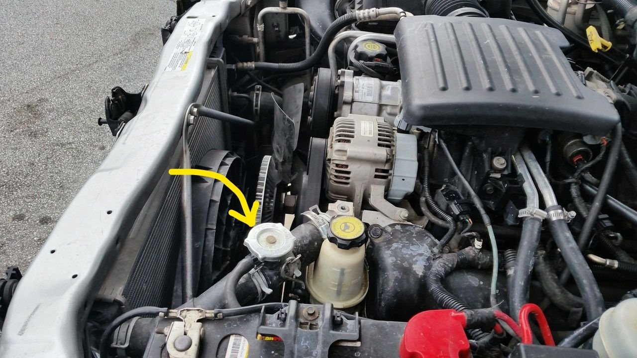

Sounds like you just checked the overflow bottle. Remove the radiator cap as well (don't do this on a hot engine). Coolant should be up to the neck. Keep an eye on it even after u add it. You may have developed a leak somewhere. Usual places are hoses and worn out water pump.
So I open the marked cap, and fill in the reservoir until the fluid is up to the neck when the engine is cool and off?
Opened the cap, after it had cooled down. There was some pressure built into it. I could see the fluid but not up to the neck (will top it up after I get the response). Want to make sure that I understood it right.

You burp it by jacking up the front or up on ramps (higher the better)and running it with the radiator cap off. Watch for air bubbles to stop and adding as needed. Turn heater temp to full hot when doing this. It can overheat for various reasons aside from low coolant. Bad cooling fan clutch, malfunctioning thermostat, failing water pump, large air pockets. Gotta figure out which it is.
