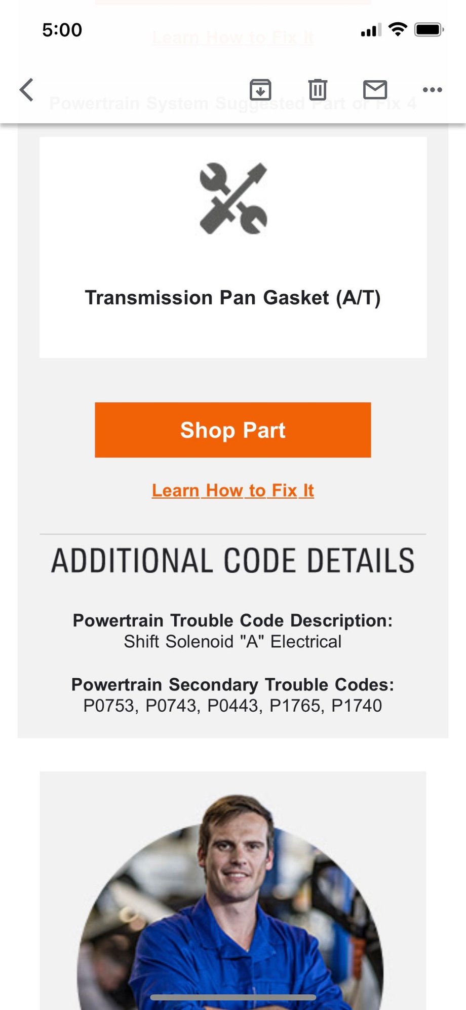

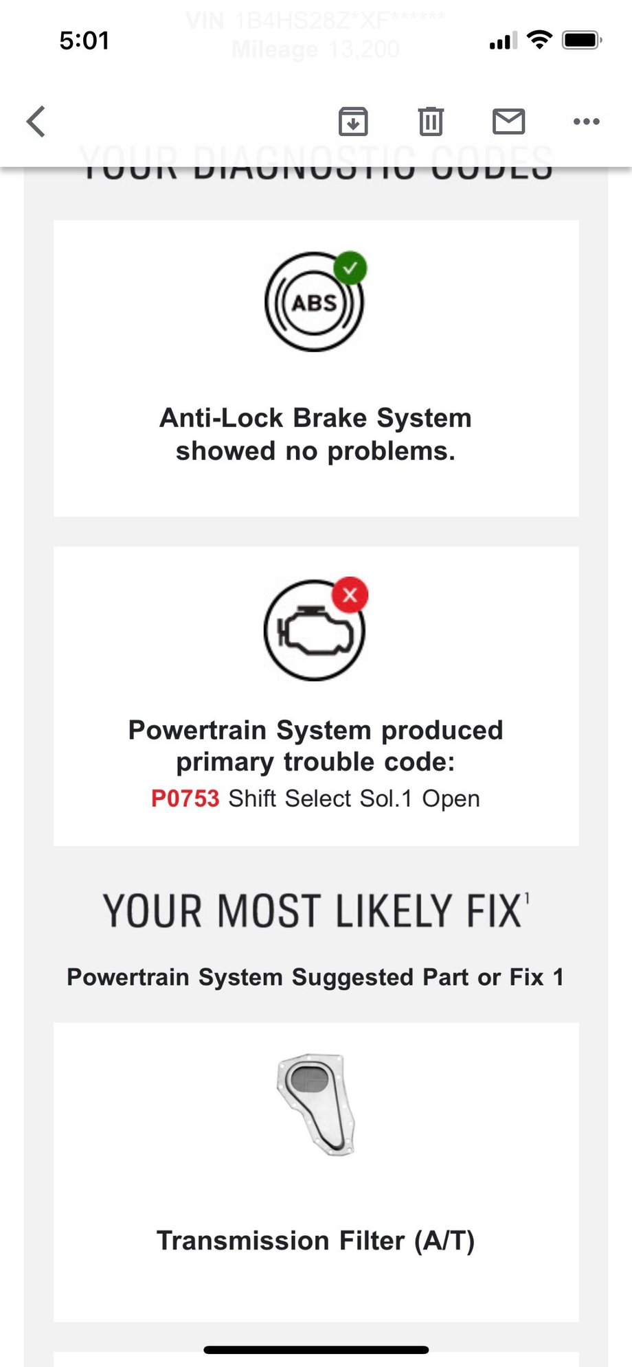

Got codes;
(non-causal)
P0443-Evan purge sol.
(causal)
P0743-Torque conv. clutch sol./trans relay circs
P0753-Trans 3-4 shift sol/Trans relay circs
P1740-TCC or O/D sol perf
P1765-Trans 12V supply relay CTRL circ.
Read at an Auto Zone. They recommended the 52118652 pt# governor pressure sol., gaskets, etc.
