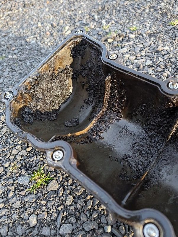

I've always liked Valvoline products. That said, an oil's first and foremost purpose is to prevent wear and carry away heat. They all claim to keep the engine clean but once the sludge is built up like in your pics, an oil simply won't remove it. Even dedicated motor flushes won't remove that. This is why I run one every 3 oil changes or so, so things don't build up. Even so, my engine shows the signs of the bad care it received from the previous owner/s. There isn't much sludge built up anywhere but everything is still black and dirty looking. I see pics of guys with engines that look shiny and new on the inside and those have received consistent care over their lifetime for the most part. Despite how it looks, the thing runs better than some motors I've felt with half the mileage

Background info:
1st - 2/3/24 - 169,135-miles - Oil and filter change - Pennzoil Platinum High Mileage 5W-30 / Fram XG8A
2nd - 2/17/24 - A couple hundred miles after the 2/3/24 oil change, I removed the passenger side valve cover and took the BEFORE pictures.
3rd - 2/23/24 - Added one quart of DEX/MERC ATF to engine oil.
4th - 9/21/24 - 170,425-miles -
Oil and filter change - Pennzoil Platinum High Mileage 5W-30 / Donaldson P169071. Added one quart of DEX/MERC ATF to engine oil.
5th - 10/26/24 - 170,635 miles - Oil change with a mix of different 0W-20 Motor Oils mostly Mobil 1 0W-20 Advanced Fuel Economy. Added one quart of DEX/MERC ATF to engine oil.
6th - 12/22/24 - 170,824 miles - Oil change with - Valvoline Restore & Protect 0W-20 / Fram XG8A. NO ATF added.
7th - 3/21/26 - 172,642 miles - Took AFTER pictures.
Before and After pictures...
BEFORE ->
AFTER ->
BEFORE ->
AFTER ->
BEFORE ->
AFTER ->

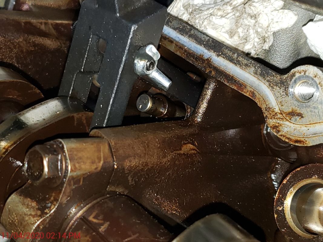

Lightbulb Issue: Wrong valve springs???
So today I set out to start the replacement of valve seals, valve springs, valve lash adjusters, and rocker arms. And I'm already starting to think I should have left well enough alone. The experience has been less than satisfactory.
First, my engine does NOT have Conical 0.635" I.D. valve springs, But this is the only choice on Rock Auto. Anyone seen this before? I.D. of original spring is 0.845". I'll post a pic below.
Second, I probably started on the easiest cylinder #2 and already lost a keeper. Luckily, I took someone's advice and ordered a few replacements ahead of time. I used the grease on finger tip trick and it's still nearly impossible to do this in a semi-efficient manor. Which leads to my next issue..
Third, for some reason, when I first started, I had decent cylinder pressure with my engine leak-down tester. Well, first, I had about 57psi when my test gauge was set to 70psi. So that's not too good. But as I worked, I lost pressure even though my compressor was running almost continuous. Towards the end I was down to 30psi which wasn't enough to keep the valve up while I was trying to compress the spring and install the keepers. Again, my first cylinder, and a long job in front of me. Well, now I have to decide if I want to source the right valve springs and re-do #2 cylinder. Who knows at this point. I may say screw it on my efforts to replace the valve springs and keep the old ones.
As promised, pic of valve springs. EngineTech # ERV1432 on left with original retainer on top. Original spring on right...
