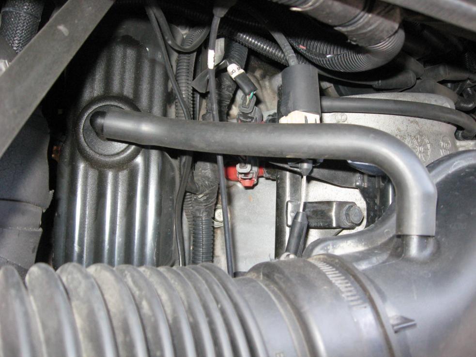

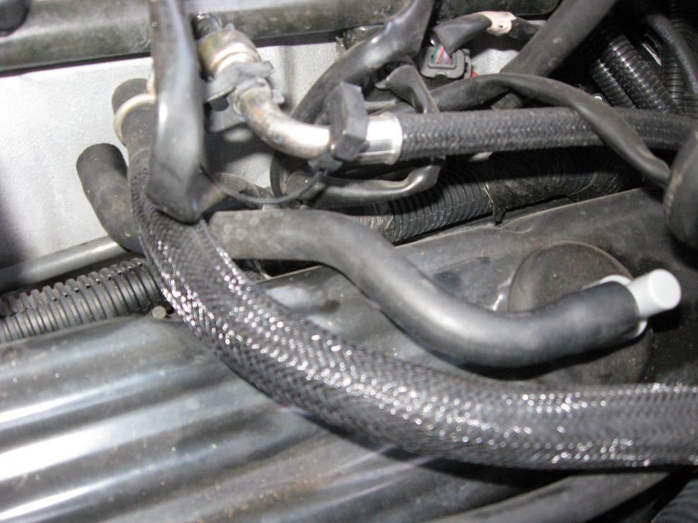

On my 2000 5.9 Magnum the driver side has the PCV valve and hose to intake and passenger side has the Elbow and hose to the Air intake piece a few inches away from the throttle body.

I found these pics online, I think they were from a post on this forum someplace if I remember correctly. Top is the PCV (drivers side) and Bottom is the elbow to intake by Valve body (pass Side)
