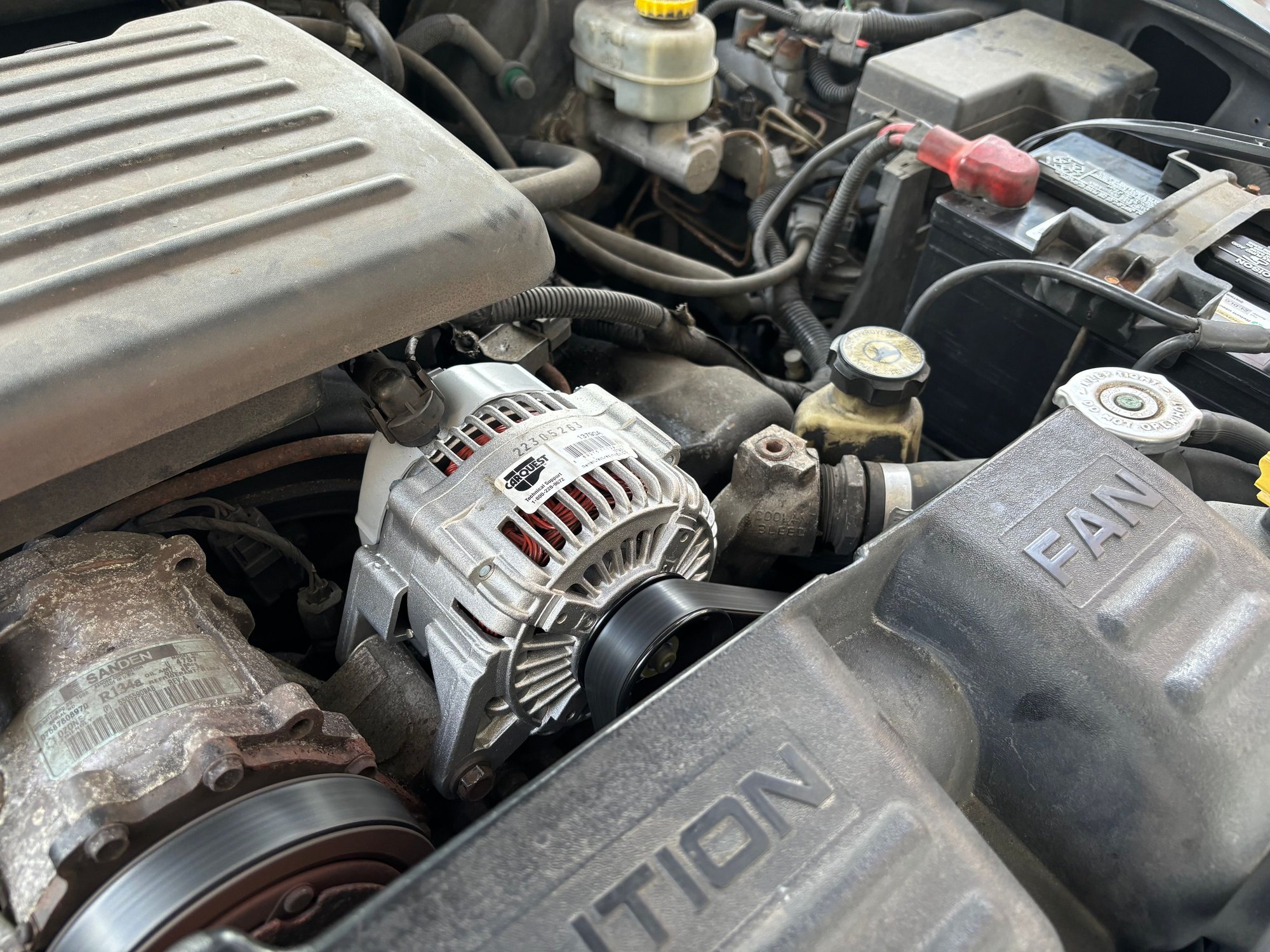

Checked the battery this morning and it had over 12 volts and it started right up. But the gauge was still reading low.
Picked a new alternator 6 hours later and the battery was completely dead. Battery was from 2018 so I replaced it as well.
Now the gauge is back to normal. Even with the AC, all the headlights and fog lights on.

Save your receipts! Don't expect long service life out of that Carquest unit. It'lll probably give you two years tops. If you have u-pull-its nearby, take your time and find an OEM alternator (Denso) out of a junked vehicle. Mine is still going good since 2020.... Nice thing is, these alternators on the 4.7L are super easy to to change.
