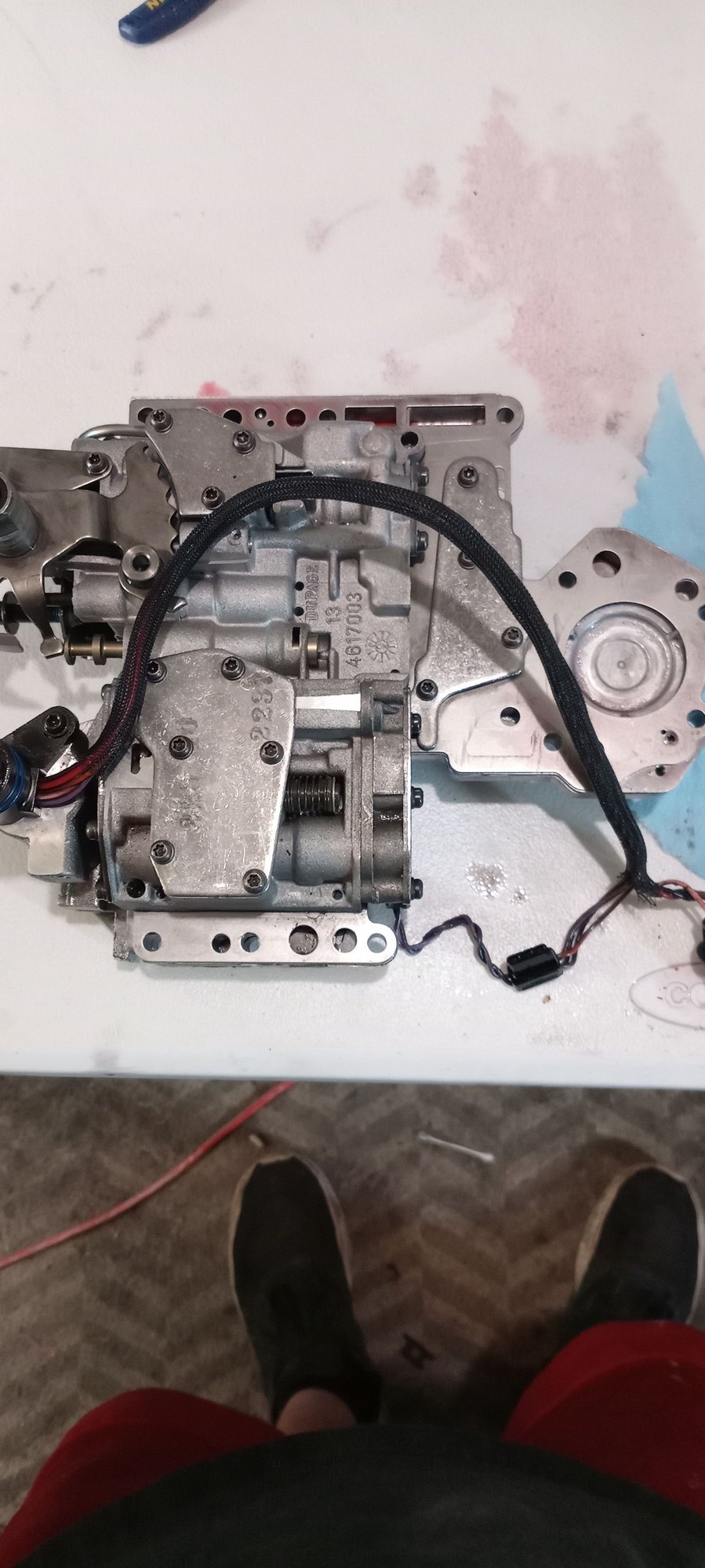

Starting to think this ball isn't a check ball but something else I'm not figuring out. Can someone take a look at my photos maybe I'm overlooking it.

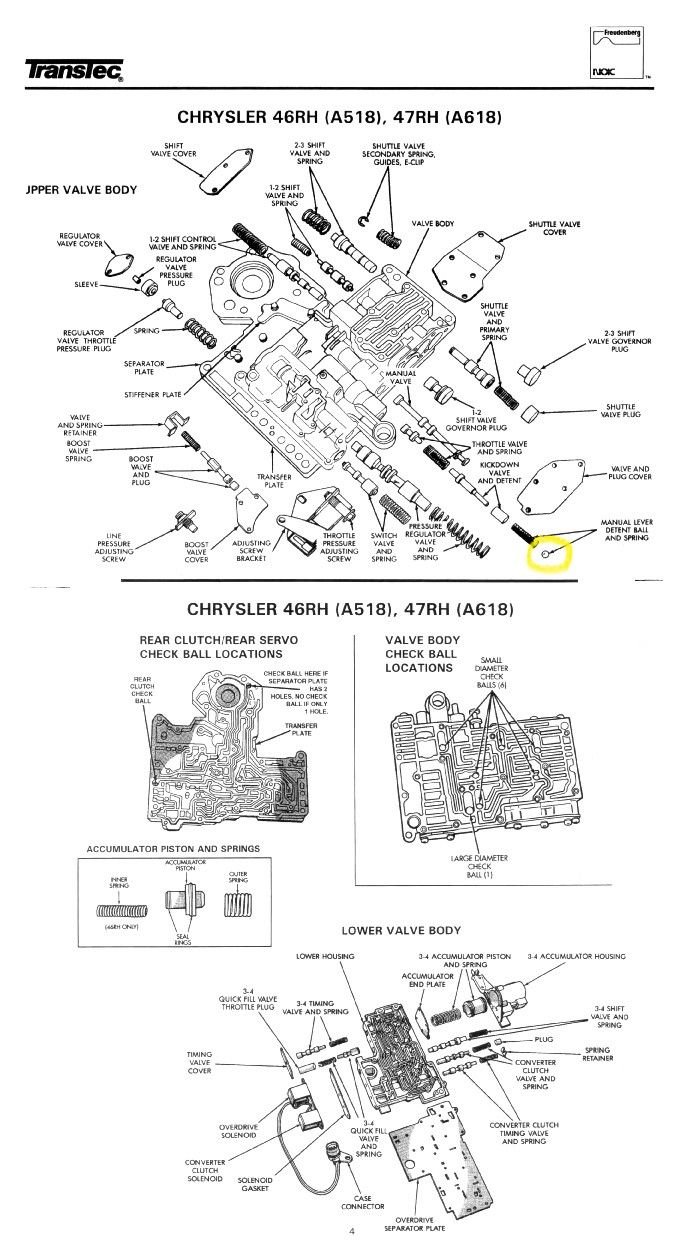

Ok I found where it goes idk if the forum stays alive long but if anyone runs into the same situation here is a photo not sure how the ball got out just by pulling the valve body from transmission

I didn't see your update, If anyone needs the ball locations check out this file, They start on page 111.
