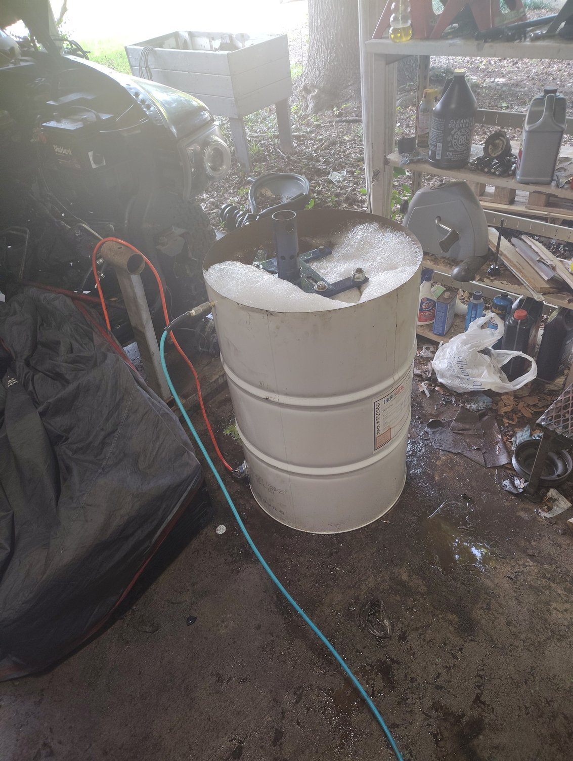

What's up folks. No help needed today, just thought I would post some updates on my engine rebuild with a home made hot tank. I'll probably post a "how to" in the tutorial section, but right now I'm just posting my progress of the rebuild. Right now she's hot tubbing
It's a crude tank, but it does the job. I swear by the degreaser called formula 88, a gallon is just 8 bucks at home Depot, and two gallons of it has been in the tank for about a hr, but it's already bringing the life back to the pistons. They had about 25 years of crud before the dip

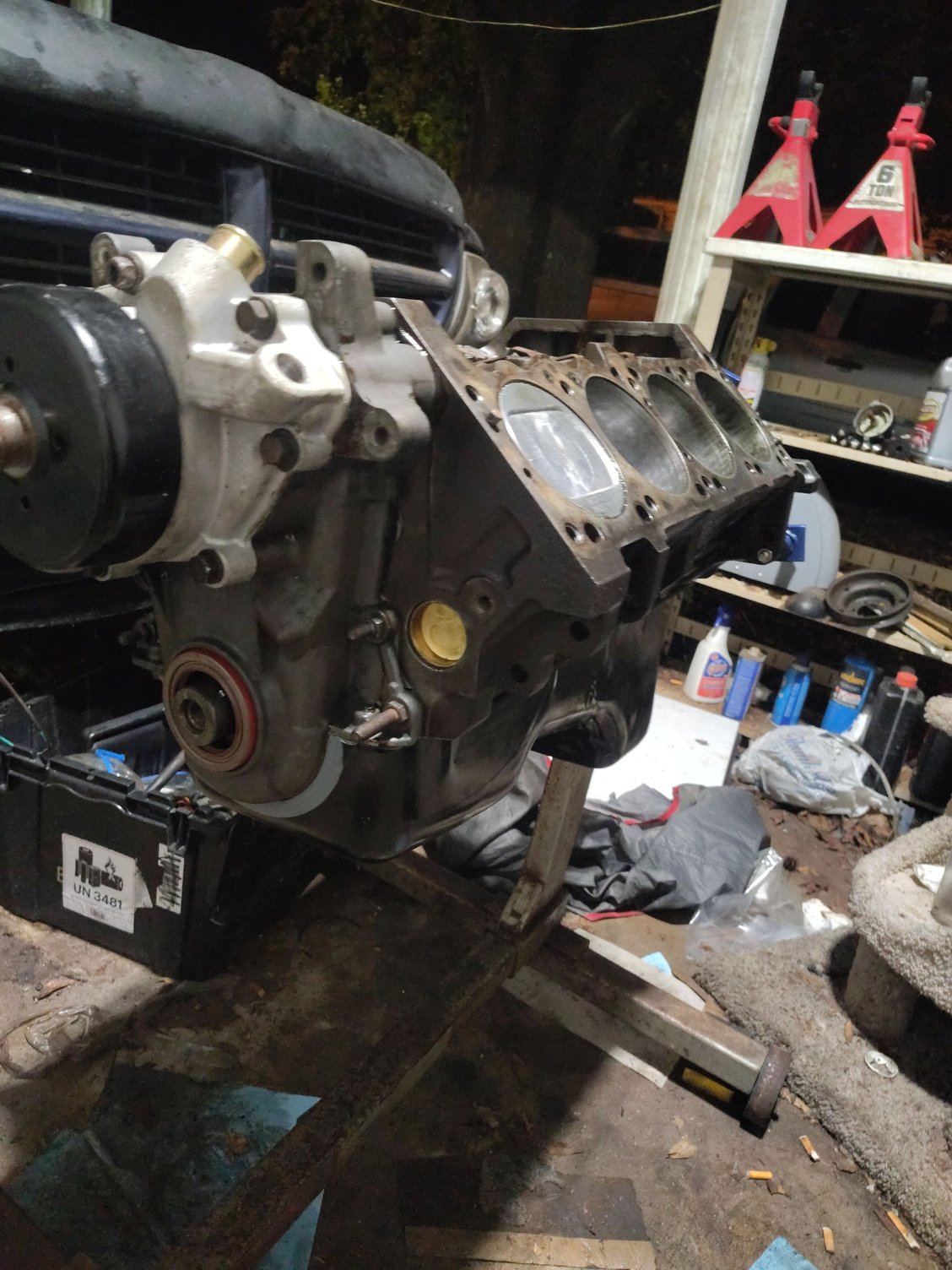

So after many house of cussing trying to find that stray bolt holding everything in the engine was out ready for rebuilding. Got everything tore down to the bare block, and got everything ready for my home made hot tank. It was real simple and cheap to make. It consisted of a old steel drum, an low watt water heater coil and a heavy duty electrical cord, and a few steel blocks on the bottom to make the engine parts don't crush the coil. Throw in two gallons of formula 88 and fill with water and bake all the crud away!
Piston heads/ connection rods went in first. Came out nice and clean after about 2 hours in the soak. So I let them cook overnight and let it work it's magic.

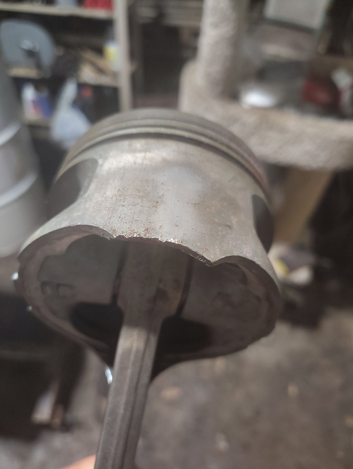

Once all the heads were clean disaster struck however, after I lined all of my heads on my work bench to clean out the railsls and get them ready to re ring, buddy who was helping me accidentally knocked a few of em off the table onto the concrete. Causing a hairline fracture in one and snapping the skirt on another.

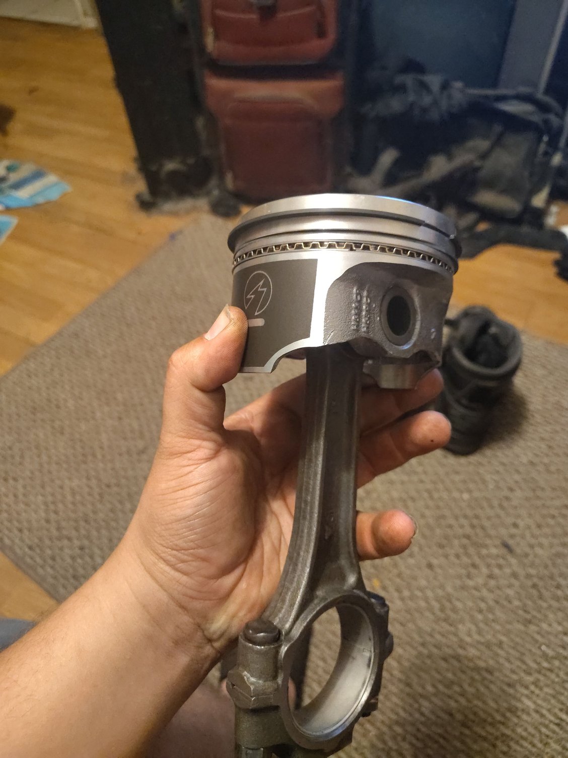

Welp guess it's time for new piston heads. Can't be mad at new parts, but I can be a little sad my wallet is on life support at this point. Some of the old rods were questionable so I ordered 3 of those too. I'm sure they were fine, but peace of mind, you know?
So at this point it's now time for the camshaft bearings. Not gonna sugarcoat it. I buggered the new ones. So instead of screwing over a new set I took it to an engine shop to have them put it in. Charge me 100 bucks to put them in, and another 50 to clean the engine because that's their policy, despite the engine not needing it after the dip 😂

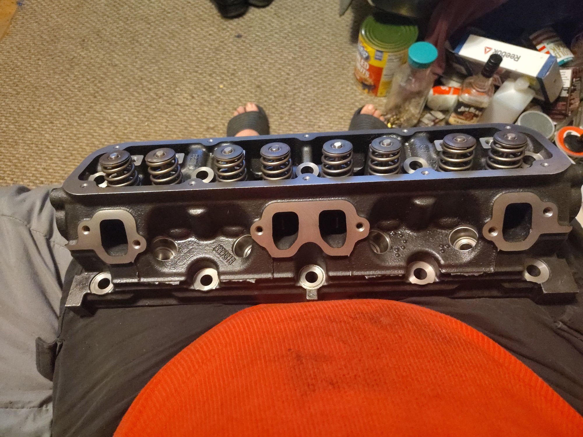

I'm not gonna even TRY to clean and condition these. Had a new set ordered at the start of this project so let's get to those. Valves are on, new oil seal things or whatever they are called are on and look pretty so now it's on to what I dreaded. I can't delay it anymore. Coil springs. God i hate coil springs.
After several hours and a few choice expletives, they are in and seated. Hammer test applied and they are good 👍

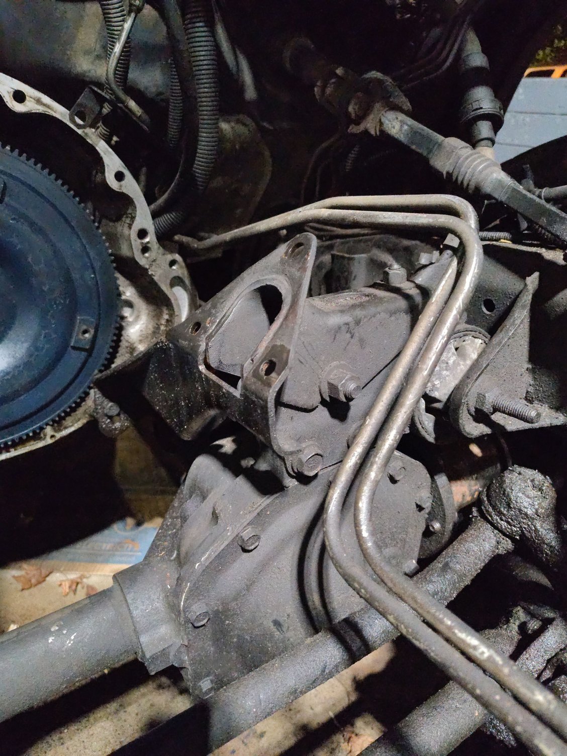

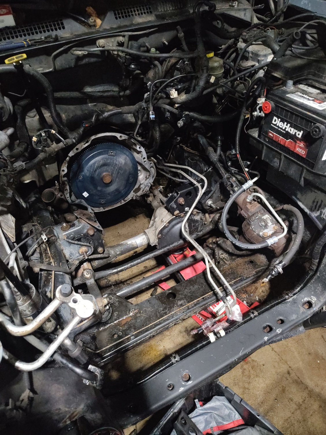

Also ignore the leveler for right now. Not going in just yet. One of my bolts to my stand decided it wanted to sudoku itself from this mortal coil so I had to fix that so she could sit level again. Now it's time to target this engine bay and get to those motor mounts and get the almost 30 years of oil, dirt, and I think several birds were unearthed from this gunk!
And that is where our story ends for now, I gotta get that last mount bracket installed and get a new bolt for that mount and then it's on to fabricating my exhaust. Everything outside the muffler is factory, and I need to add a larger diameter mounting point since my new headers are bigger then stock. Oh! And to rotate my bung for my 02 sensor so it's not on the top of the pipe so I can get my fat sausage hands in there and change it in the future!
