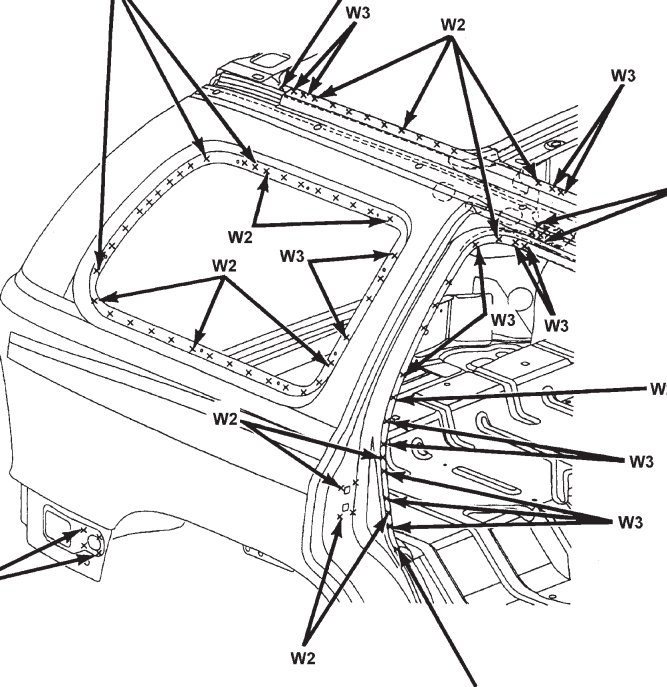

Old Jun 8, 2025 | 04:04 AM
James Vining's Avatar
James Vining
Joined: Feb 2021
Posts: 96
From: Milwaukie, Or

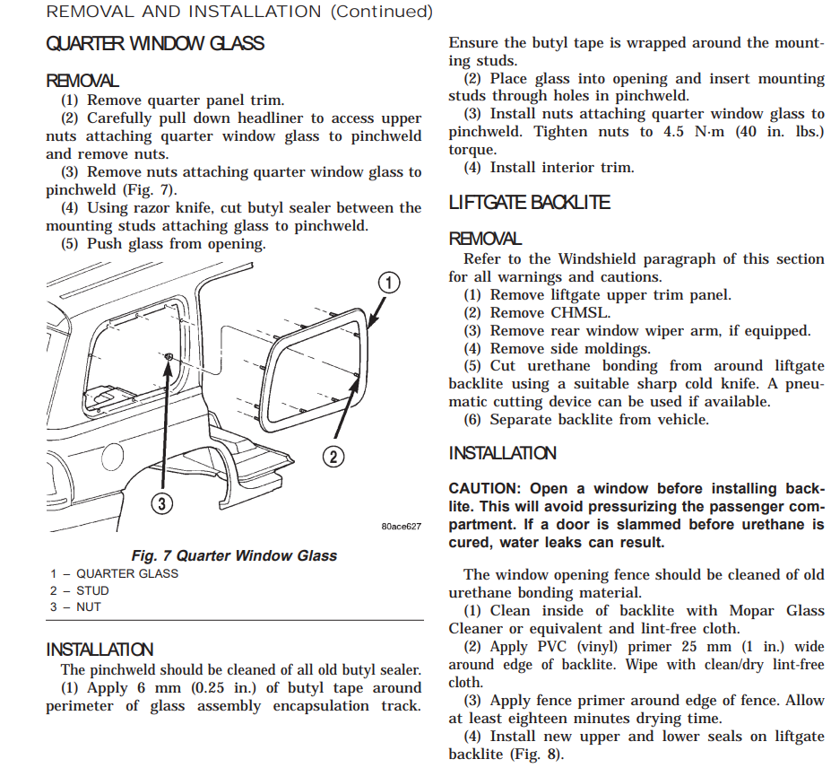

Old Jun 8, 2025 | 08:43 AM
Posts: 87,475
That doesn't look too bad.... Having to disassemble the interior likely isn't fun.... Can you even get to the spot that is leaking from the outside, without removing the window, or, at least, loosening the nuts?
Old Jun 9, 2025 | 10:19 AM
James Vining
Joined: Feb 2021
Posts: 96
From: Milwaukie, Or
Nope
the glass extends approx 2" If I remember correctly from when I did the R Side.
Actually the easiest part is getting the inner trim off the head liner just has hang down about 2-3"
Now getting a thin razor or super sharpened putty knife between the Rubber item where the butyl strip sits and the welded window sill there is the PITA especially in a pouring rainstorm (as I had to do on the L Side.
