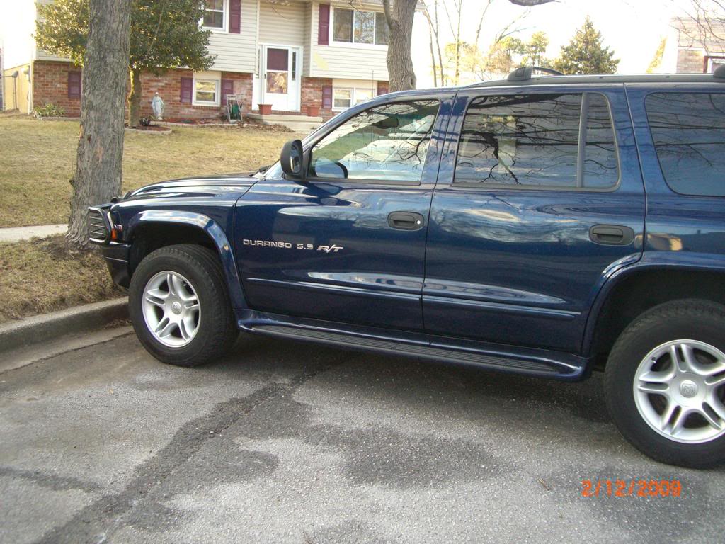

I have a 2000 R/T and it doesn't have AWD, it has 4WD(fulltime).
Also when going into 4LOW, the manual says that you should be slightly rolling(less than 5MPH) and the tranny in neutral.
Pic of my shifter

It really needs a detail job! It is 9yrs old Only 70,000 miles!
