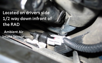

Hello All! Well from talking to one of my well trusted parts guys whom I have been dealing with for more than 20 years and who no mater what vehicle you talk to him about knows absolutly everything about it... He prompted me to replace the Ambient Intake Air Temperature Sensor, from what I understand a commonly overlooked problem but with that being said a very rare problem indeed, he has never steered me wrong or provided a wrong part in over 20 years... Nice track record!! So along with the Ambient Air Intake Sensor I will also replace the Intake Air Sensor which is completely different and in a totally different place on the 3.5L's engine, have not looked on the '93 trep to see if it is in the same place, but I imagine it is.
To remove the old sensor, you willneed a long handled flat screw driver, place inbetween the sensor bracket and the metal on the front bumper, when you see it you will know what I am talking about, with one sharp blow it will break the rivet, punch out the remaining piece of riviet from hole. The hole is just a hair smaller than a 1/4" bolt thread. I used a small screw, washer, lock washer and nut to hold this on. It was a quick and simple replacement, but is a little tight if you have big hands.
Cost: $22.95 CAD - Parts Unlimited talk to Tom, 727 strip mall behind Franklin mall N.E., Calgary Alberta, Canada.
Time to change out: 10 minutes.
I will let you all know how the car performs and hopefully all will be well and this can be of use to someone else. My Parts guy tells me that he has heard from past customers it has made some big improvements on engine performance.
See pics of what and where the Ambient Air Temp Sensor is located, not to be confused with the Air Intake Sensor.
Cheers!
Attached Thumbnails Intrepid problem with stalling-aais.jpg   Intrepid problem with stalling-aais-1-.jpg
