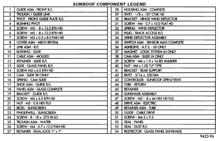

Here is the clearest sunroof image that I can find, do any of these parts look like the guilty party? The only seal in the sunroof assembly that keeps out wind and water is the one attached to the glass itself. The rest are to seal off individual components. #52 in the image below is the seal on the glass and it is not serviceable, meaning it has to be replaced with the glass.

After looking at it again, the gasket around the window is fine. The issue that I see is that the window does not sit flush when "closed," it falls below the roof of the car. I think the culprits are the springs that I believe are supposed to help support the glass when in a closed position.
Edit: At least we THINK It's the springs. Whatever it is, the sunroof glass is not being supported the correct way at the rear and just falls in, causing that wind noise.
At the moment I've gotten around it by "venting" it, then carefully closing it so it's more or less flush with the roof.
