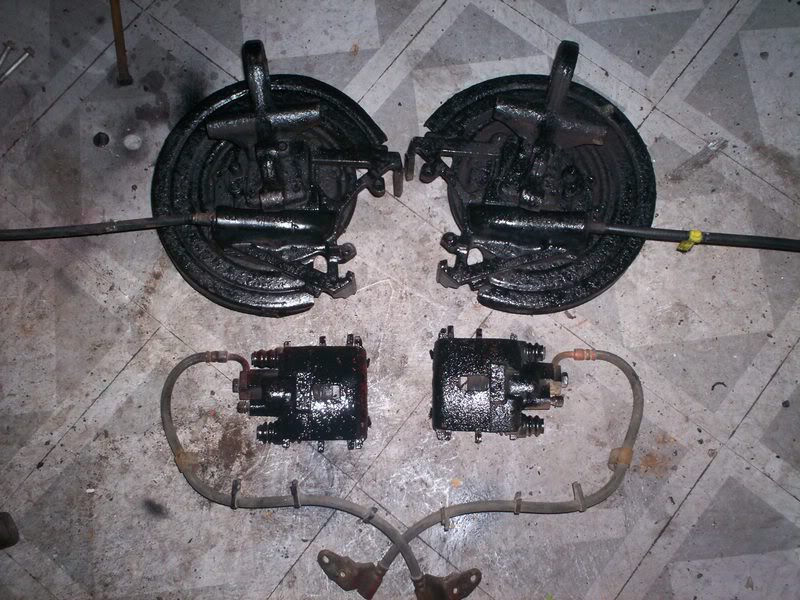

Default rear disk conversion
its been awhile since i posted anything well i went to the local junkyard and got im pretty sure everything to do the swap there a mess right now cleaning them and painting them later heres a pic if anyone can tell me what all i need would be a big help to see if i missed anything there kinda just thrown on the floor lol i have the entire rear hub e brake lines rotors calibers brake lines and hardware
(i am going to clean them)( i paid 30 bucks for everything good deal???)

looks like you got everything....
$30 isnt a bad price

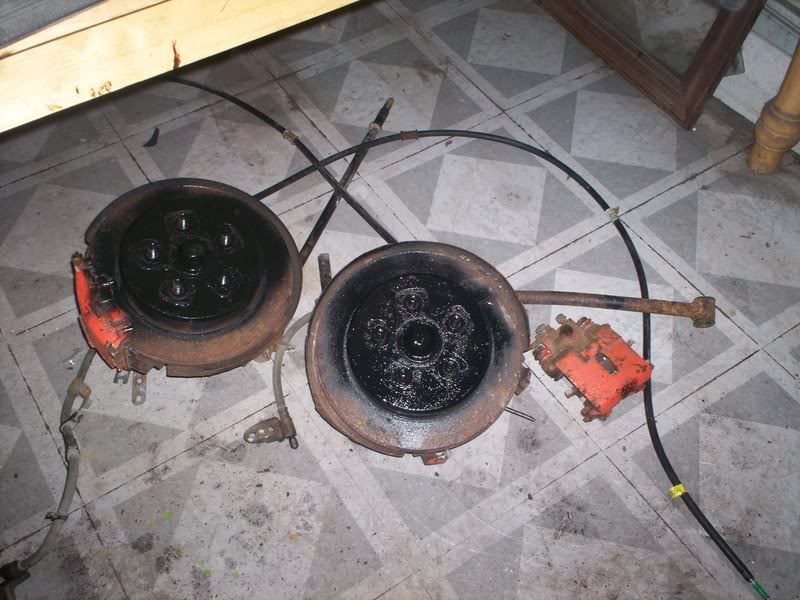

i cleaned them up alittle bit the calibers are gunna be sprayed gloss orange (ceramic heat paint) and the knucles need another coat of black other then that they look alot better then before
