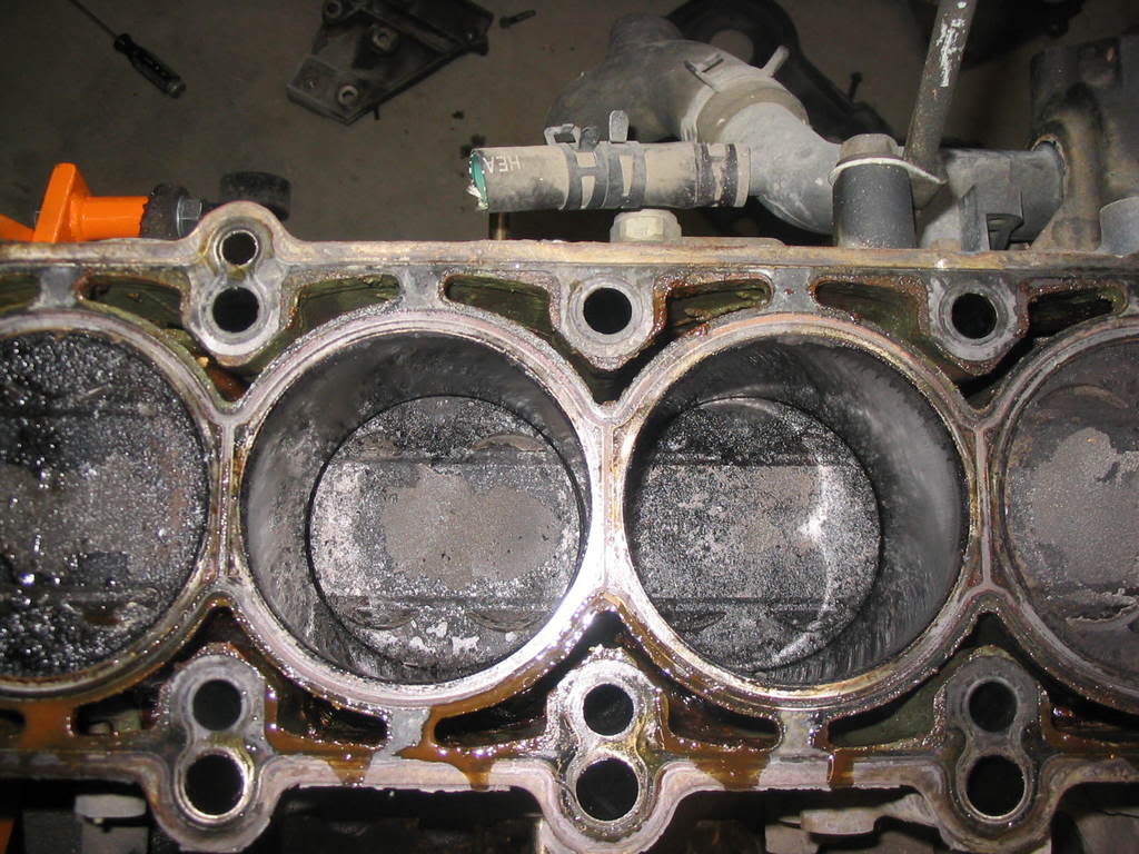

What is the best way to clean the pistons while there still in the block??? Soft wire brush, scotch right pad??? Does simple green hurt pistons????
heres some pics...

wow...those things look pretty nasty...looks like its been burning alot of oil..
you can use pretty much anything to scrub off the pistons, abrasions wont hurt them, its the cylinder wally you have to be carefull with..
i wouldnt suggest simple green incase it drips into your pistons rings

I ended up turning the crank a 1/4 a turn to get all the pistons in the middle and spraying enuf brake cleaner to cover the top of the pistons let them sit for about an hour and then brought 1 and 4 up and the carbon pretty much just wiped off... exept the valve relife's I used a scribe to get down in there and get them clean....
Is it ok if there are some superfical scratches on the piston???
there not deep just maring the serface a bit...

scratches wont hurt them at all....

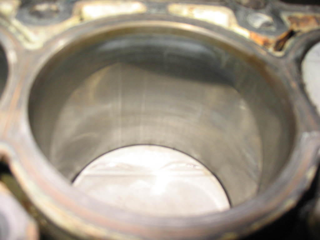

heres some after pics tell me if all looks good...
All four

1 & 2
3 & 4
cylinder wall they all look the same...

you should go ahead and hone the cylinders since you got it all apart, they kinda seem glazed to me.

yeah i would definatly put a hone to them cylinder walls. other than that the pistons cleaned up well and while you have it apart you might as well replace all the bearings and rings. make it just about brand new
