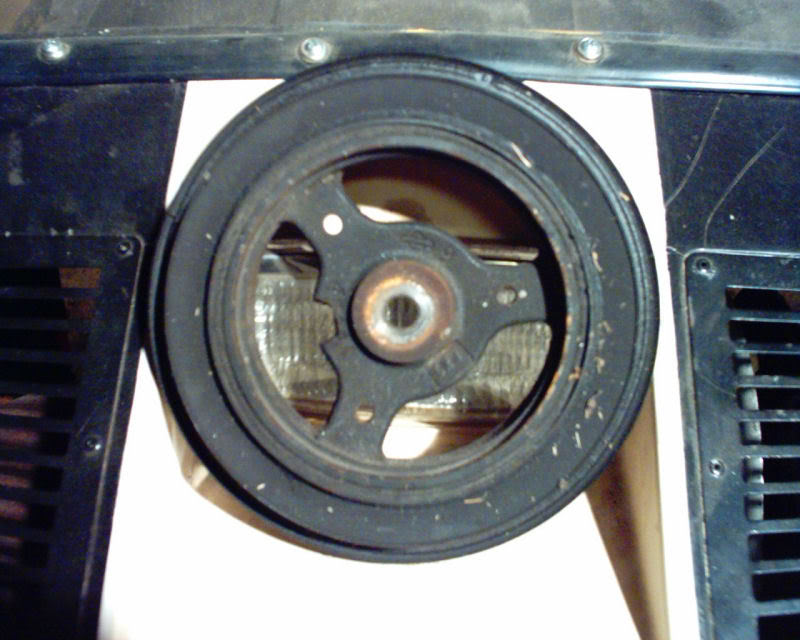

Got an air compressor from a friend and decided to cut the pulley off because there was no way I was gonna get it off now since the one spot was busted off.. I got the outter part off.. just enough to be able to get the timing cover off.. but now I still have the part of the pulley that goes on the crank remaining.. How do you suppose I can get this part off?? I tried applying the puller again, but no luck.. it just pops off with any kinda pressure.. I can't apply it in the same spots.. and the cut off wheel I have is going to damage the timing gear! I think I am pretty well screwed unless someone has suggestions!! I need them ASAP as I have to use the car to get to class on monday!!! Else I am forced to ride my motorcycle.. don't want that!!
[IMG]local://upfiles/32764/9C06BA367F3B409DB82268FBAE3328D7.jpg[/IMG]

get us a little better pic maybe more light and back a little further... I had a friend that did almost the same thing and want to see if your able to do what we did...

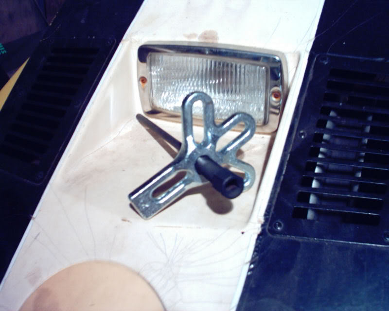

I had that problem on my 97 and here is a solution. Drill and tap all 3 arms about in the middle, get a standard puller use the main bolt and rods from the other puller, worked for me here's a couple pics.
Hope that helps.

I got it off... I'm effin retarded though.. long story short: The pop I felt/heard was actually the pulley breaking loose and I didn't realise... Yes, laugh laugh.. haha.. So now I need a new harmonic balancer and timing belt cover.. fun fun
