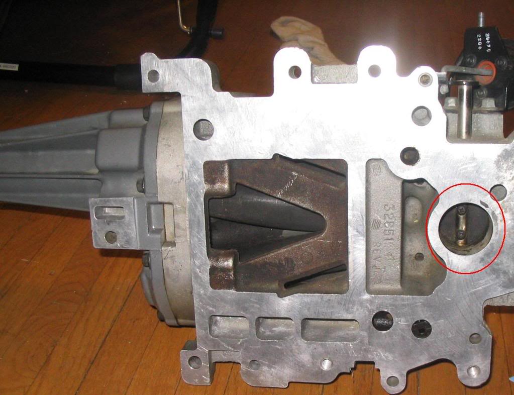

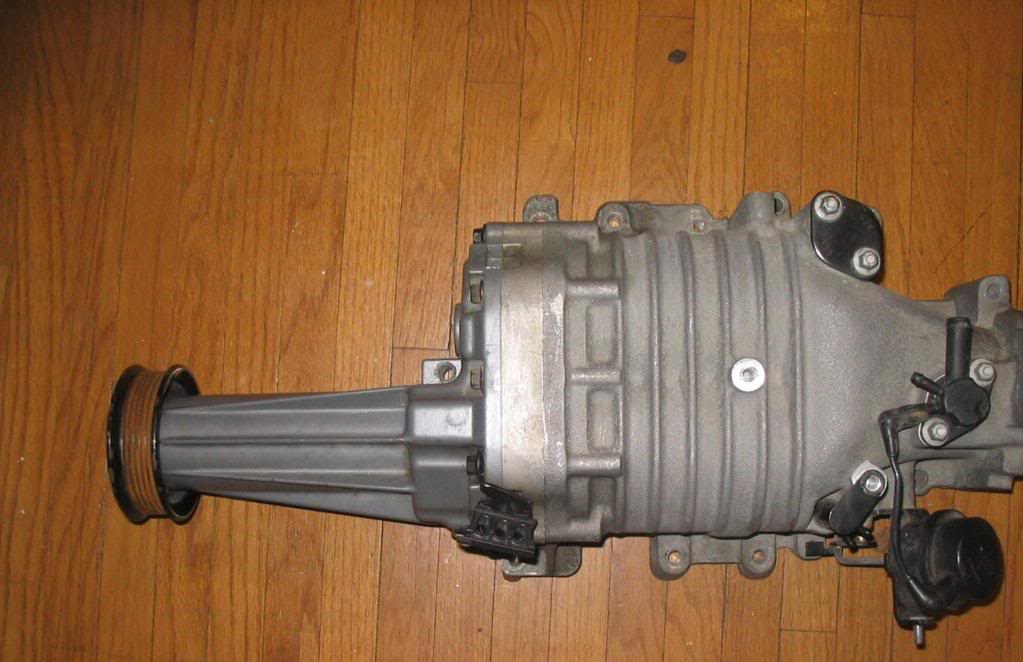

this is the supercharger that comes on the bonniville...
eaton m62

yeah thats right - you have that s/c dont you??? just not fabbed up yet. then there is a red neon that already has the s/c on it. i think it had PA tags if i remember correctly. what is an m62 good for? like 5-10 psi on the bonneville right?
