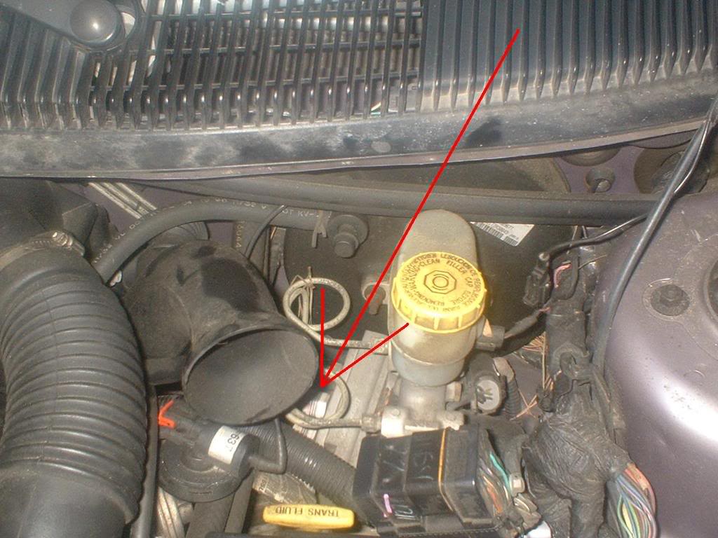

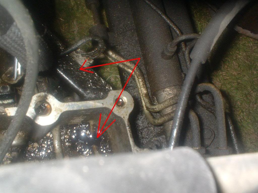

Ok guys, I did a search but didn't really find anything in the area I am looking for!! I have recently started having an oil leak, When I first noticed it is when I would come to a stop I would see some smoke coming from the cowl, but if I had the air on I could smell burning oil in the car. Ok, now here is where I will try to explain where I am finding theoil. While standing at the drivers fender and look on the passengers side of the master cylinder, through the lines on the master cylinder and (I guess it would be the brake proportioning valves?!?!) You should be able to see what I am taking as the tranny bellhousing, there is a small puddle of oil on it, and there is oil on that side and the back of the engine. I reached in and wiped all the oil from the puddle on the bellhousing yesterday andthis evening I look in and see another small puddle of oil there.I have had nor can I find any oil in the coolant so I am thinking it is not the head gasket, and I can see most of the valve cover gasket(with the aid of a mirror) and can't see any tell-tell signs of oil leaking there, so any body ever had this problem or have any suggestions before I take it to a garage after the holiday????? There is also oil on the underside of the car and oil on the ground under the car, it seems to be going through about a quart of oil every 2 weeks or so!!! ANY SUGGESTIONS?!?!?!?!?!

Ok here are a couple of photos that MIGHT help!!!
These are where I was looking

The large circle is where the oil was before I cleaned it up and the small circle is where it was tonight

switch the IMG to img and they will work... the img part needs to be lowercase... yeah its stupid i know...

my rear main seal wore out and had my structural collar looking like that - and my trans covered in gunked oil

Headgasket leaking oil?

Turned out to be the rear main, dosn't leak a drop now. Thanks guys!!

thats probably the FIRST place where neons start to leak oil.
