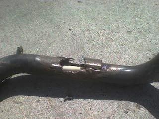

This is what happened when I thought to take a wire wheel to the "surface rust" that I poked through... I planned on fixing it, before this, with epoxy.
http://img.photobucket.com/albums/v6...t/DSC00771.jpg

Ah crap. It was a temp fix that turned into smthing more.. I need a new filler anyway since the whole thing was rusted just not rusted thru yet.

I guess you could do it without dropping the tank, but it's seriously not a big deal. New straps are $30, make sure to have them on hand incase your bolts spin. A good tin snips will take care of them. I didnt have any problems with mine, i soaked them with PB blaster every night for a week before hand... Check the filler neck before also, if it looks rusty, especially around the factory patch (which does NOT help), plan on epoxying it at the least (or replaceing it)
