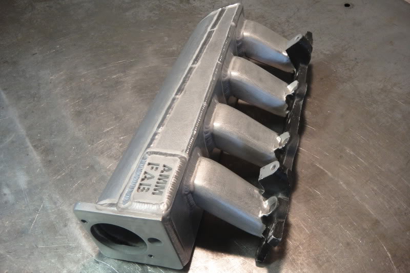

i use to make them and ill be making more in time..... heres what my latest and greatest sohc intake manifold looked like before i stopped making them......
mike

I think AMM had been building intakes since before I owned my first neon. I have owned 2 of his intakes and I really liked them. I also have friends that run them, no complaints. AMM knows his stuff. Name is well known! If I were to buy one I would buy the AMM over the indy.

It looks nice, but over a polished d90 Indy, the dynos from the intake shoot out has just small difrenses. Dont know about the stock indy...

i dont remeber exactly but i think the intake that was tested was a very old one of mine and it still came in 3rd over all being bested by both sets of arthurs itb's. i wish i could have had a set o fmine tested. i think the number my intake made was 208whp. it was a short runner so it lost a little down low but made big power in the mid to upper rpms range wicth is pretty standard when u shorten the runners. the problem with the indy is the cross sectional area of the runners are so damn big u loose alot of velocity and there for alot of low end, even with the medium length runners it has and not to mention they are pricey.
mike
