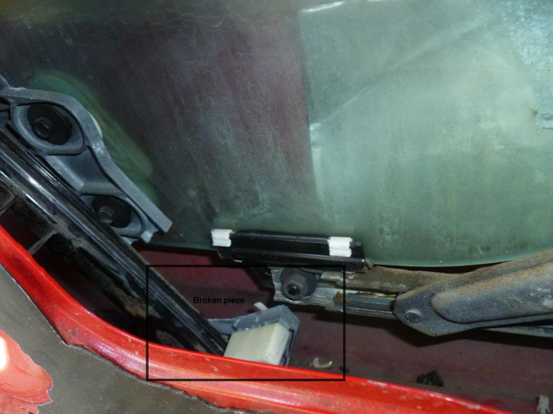

1997 neon sport coupe drivers side door window came off track and I found it to be one of the off track. I took a picture (see attached pics) of the broken item. I think it is a drivers side rear channel and lift plate.
I have the following questions:
a. Does anyone know where I can order this part online?
b. Does anyone have a little tutorial on how to replace this piece or assembly?
Thanks in advance.

rock auto. and when you buy a new one theres a write up on neons.org how to reinforce the new one so this doesnt happen again.
