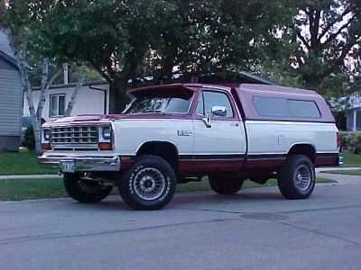

My 85' has/came with 8 bolt 16.5" factory rims . Also a Winnipeg truck.
Chryco
