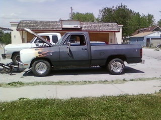

I went from a 360 to a 400 in my 83 Shortbox. Driveshaft worked fine so did the trans mount. All you need is Bigblock truck mounts(2wd for 2wd and 4x4 for 4x4 they were diff)If you had a smallblock youll need to lengthen the coil/distributer wires if you go 440 you need a bigblock booster( If you have power brake otherwise dont worry remember a 440 has a taller deck hieght that the 383/400s) and youll need adequit cooling. I used the radiator that was in it and it suprisingly kept it cool. Pic of the 83 and a pic of it ready to pull from a 2wd 87 Ramcharger
Attached Thumbnails My Finished 440-phonepics-094.jpg   My Finished 440-phonepics-408.jpg
