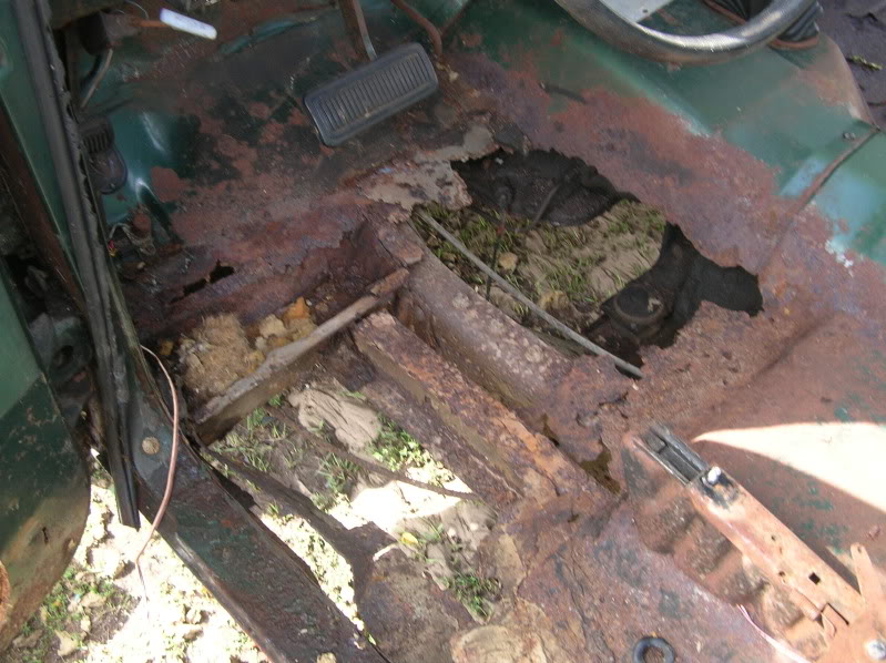

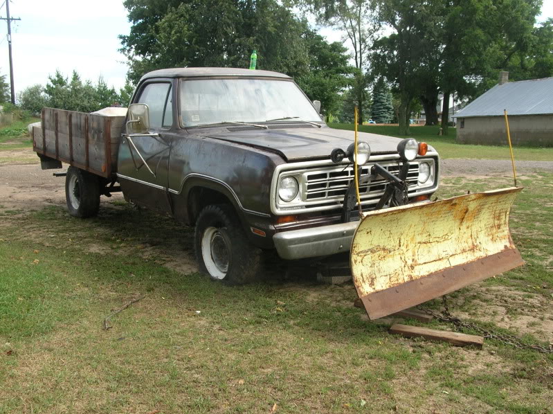

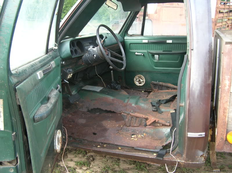

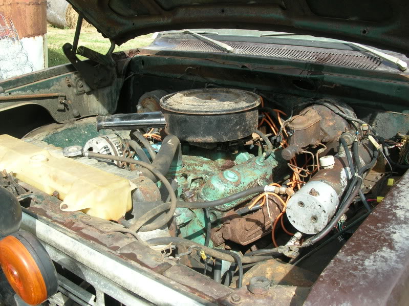

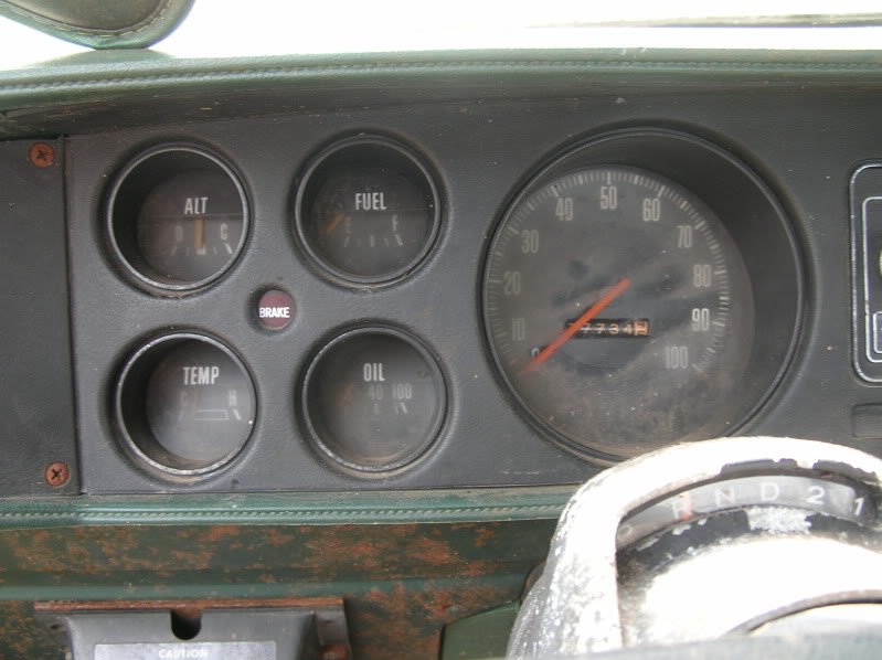

Finally got some decent pics, enjoy...

Btw, these were taken AFTER it was power washed inside and out.

That is not a 440 engine. It is an LA, either 360 or 318.

Ya know what, I was pretty skeptical when I was told that it had a 440. Even in the dark it didn't really look like any 440 I've ever seen. The placement of the dist. should have been a dead giveaway but I was too busy looking at the floorboards (or the lack thereof) Thanks for pointing that out charlie1935. I'll find out tomorrow what it really is. Boy, what a let down, if it only has a 318 I think I'm gonna puke.

if the rockerpanels are solid and the doors don't drop then i would weld some new floors in. i they aren't solid i would look for a new cab. a new cab might be a little easier. specialy if you are missing interior part like the seat. i would also make sure that the frame is solid before you start doing any major work or spend too much money.

Well, the rocker panels are completely shot. If I stepped on one I'm sure they wouldn't hold my weight. I just plan on welding/riveting in a new floor. It doesn't have to look pretty at all, it just has to function. I have the seat assembly, it just doesn't have the bottom cushion. I'll probably just get a new cushion for it.
The frame is solid, that was the first thing we looked at. I'm not trying to do a complete restore. It doesn't have to ride comfortable or look decent or anything like that, all it has to do is run down our 1/2mi driveway a few times during the winter.

I postew without reading all the thread, I just looked at the pics and your right, its probally a 360 since its a 3/4 ton.

Its probably a 360,But those 318s are very good Engines.My dad had 3 of them. (He blew the first one in his '89 Ram then went and put another one in it,and then he another Dodge that had a 318...)
