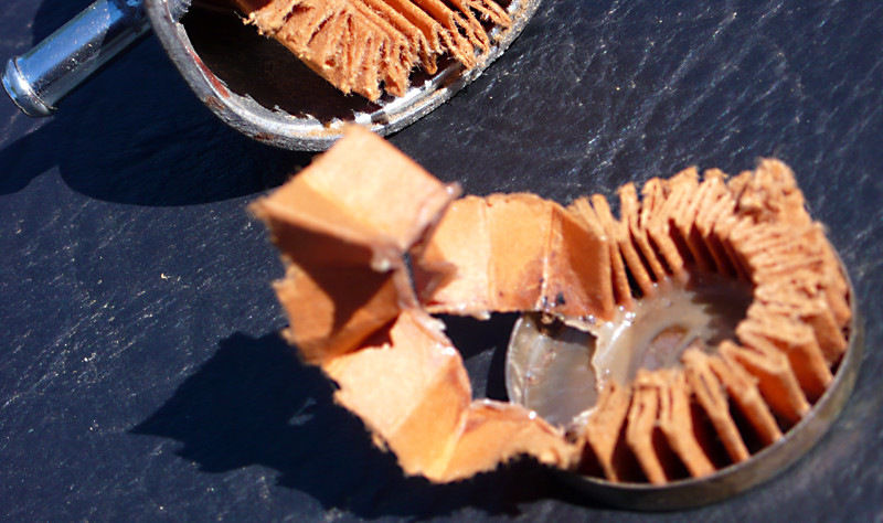

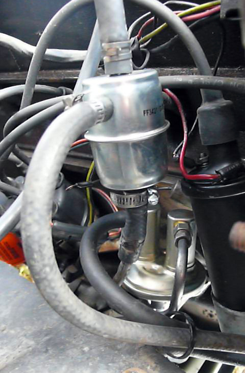

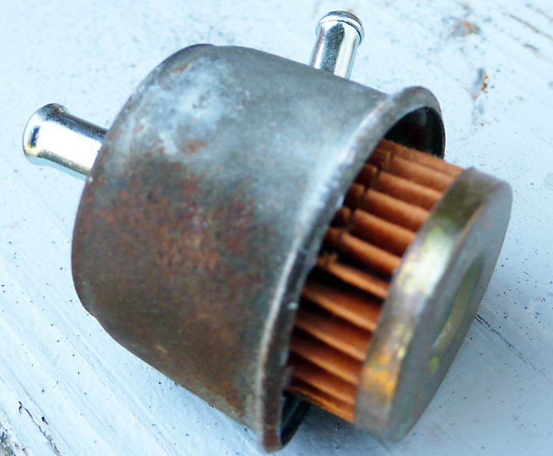

I separated the fuel line just after the new fuel filter and tried turning the engine over several times and there wasn't any fuel moving through the line. So, I've gone ahead and picked up a new fuel pump in town. I also cut apart the old fuel filter cylinder to see what the filter looked like. I'm not sure what a new one looks like (whether it may be white or yellow when brand new). When I returned the first fuel filter, I learned that I needed one designed for California's emissions standards - so it appears to have a line that runs back to the tank. Is the second line to add extra pressure in the tank, or to double filter the fuel, any ideas?
Old fuel filter:
New fuel filter:

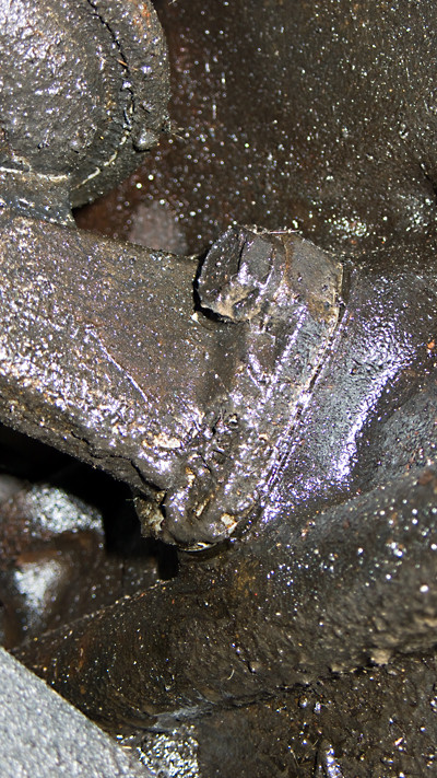

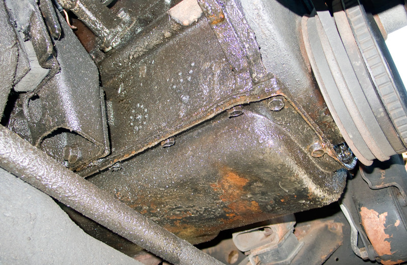

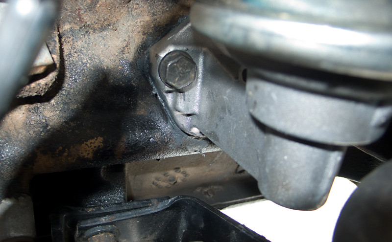

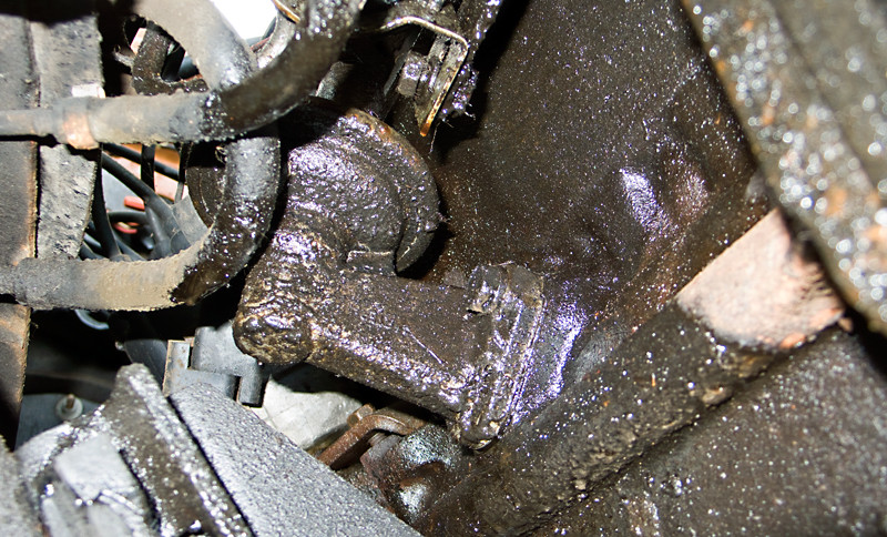

The bottom half of the engine on the side of the fuel pump was extremely gunky from a long period an oil leak. Before trying to remove any parts, I've tried to clean up the engine block a bit.
Oily engine block & fuel pump:

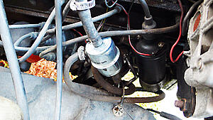

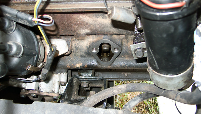

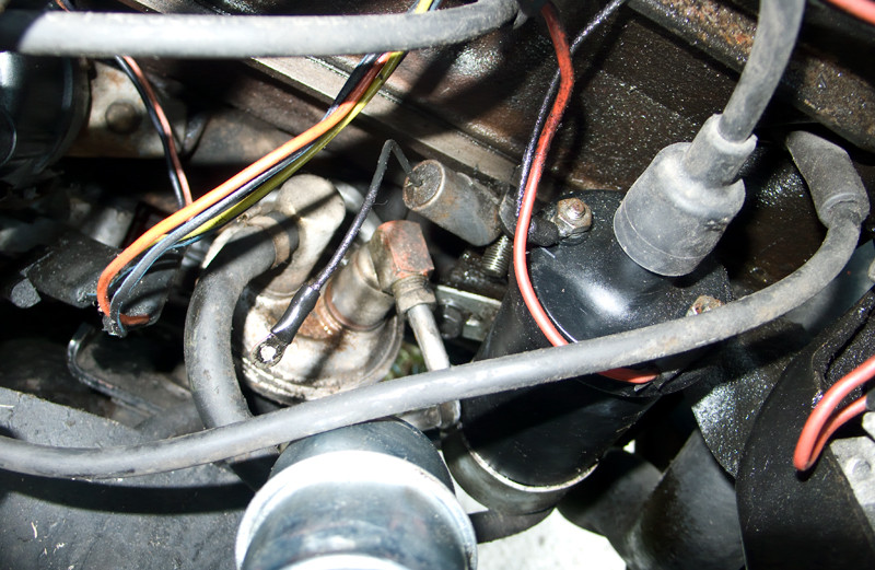

Just before I removed the fuel pump, I noticed this wire (dead center, hanging over the fuel pump) that was not attached to anything. It has a short wire, so it much attach to something close by... any ideas?
Mystery wire:

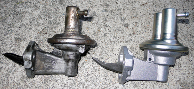

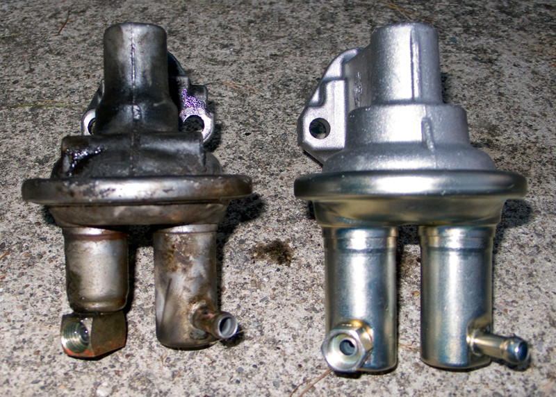

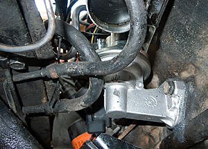

Fuel pump removed from engine:
The old fuel pump was made in Canada and had a manufacture date of 1994, so I assume this was replaced before.
Old fuel pump with new fuel pump:

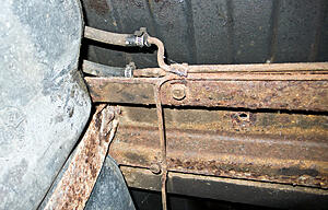

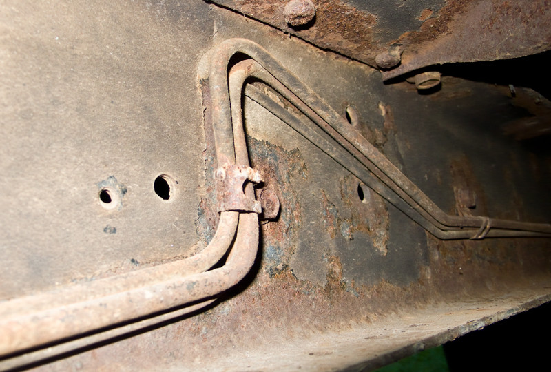

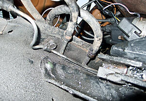

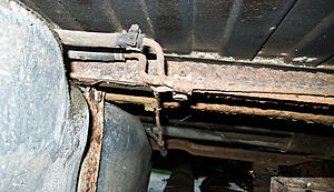

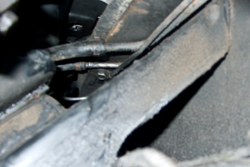

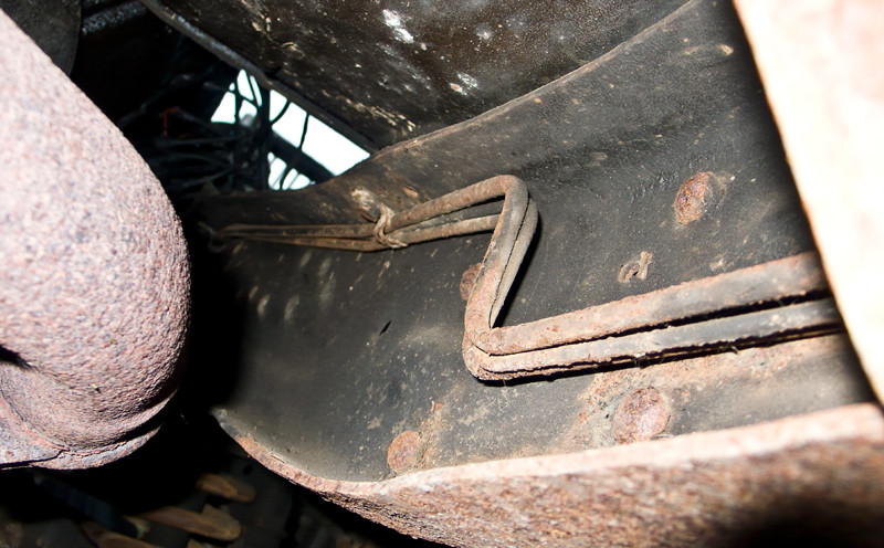

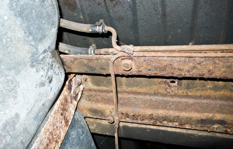

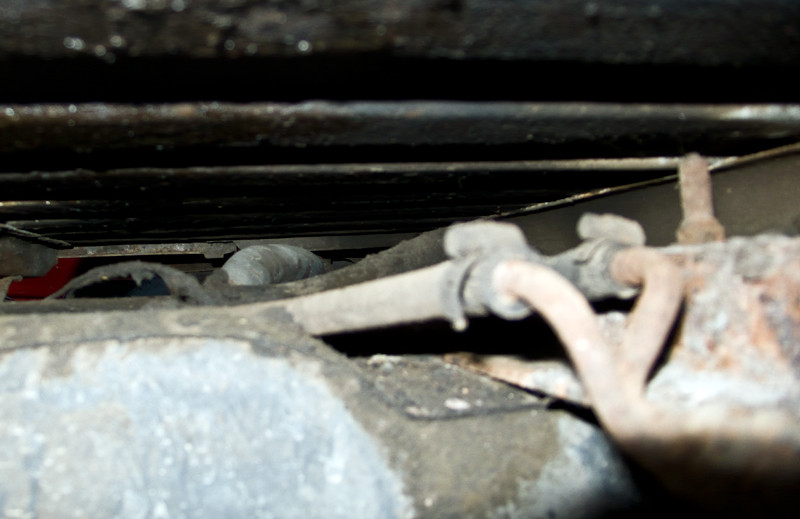

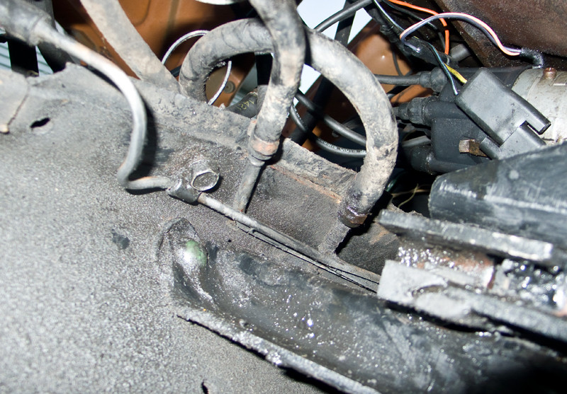

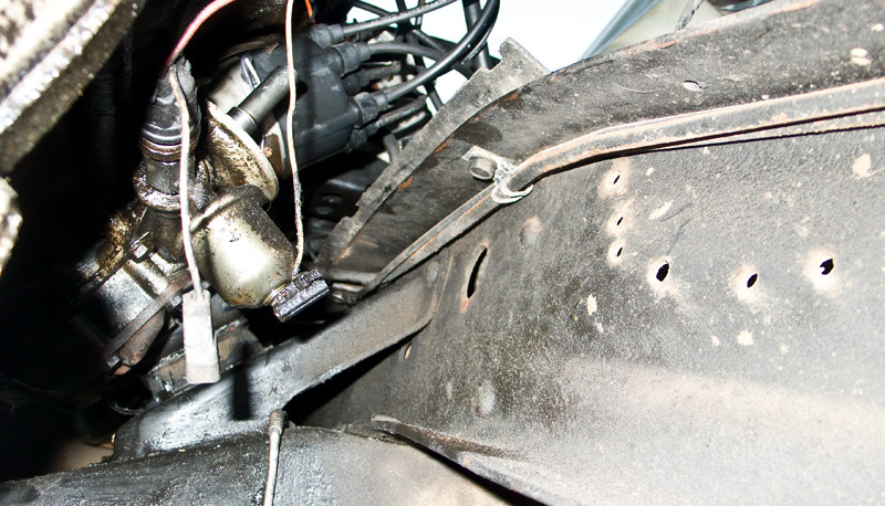

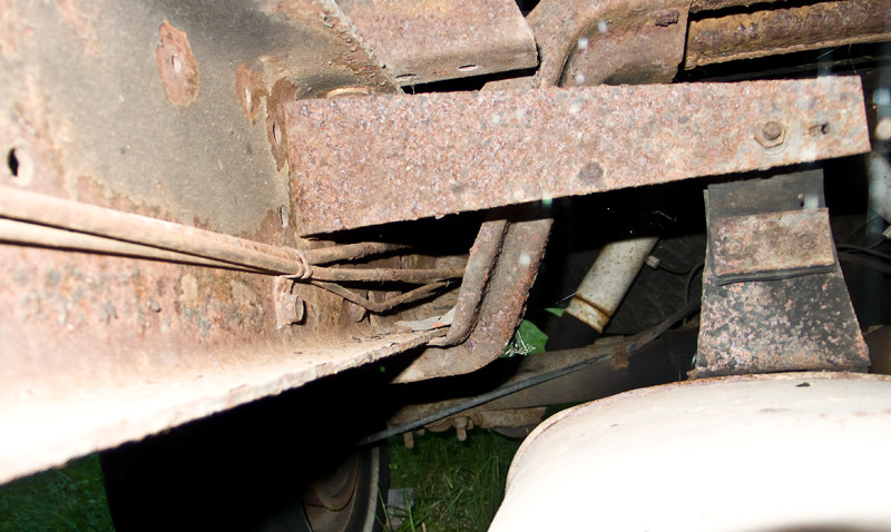

I wanted to share the condition of the fuel lines because I'm not sure if the exterior rust is normal or excessive and wondering if maybe they should be replaced?
Fuel lines from the input of fuel pump back to the tank:
(rubber tubing from fuel pump meets the metal tubing in frame)
(rubber tubing from fuel pump meets the metal tubing in frame - another view)
(further down the frame)
(first bend mid-frame)
(second bend mid-frame)

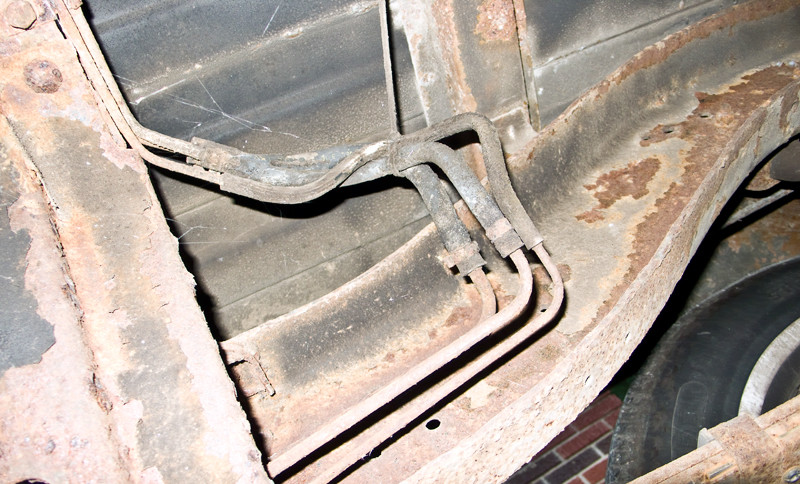

(lines separating before crossing over truck bed)
(making the bend across the bed)

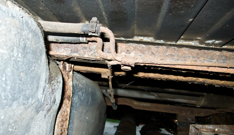

(just before tank)
(just before tank - another view)
(crossing on top of tank)
Thanks for reading, taking a look at the images and for any help!
Old fuel filter:
New fuel filter:
Mystery wire:
(just before tank)

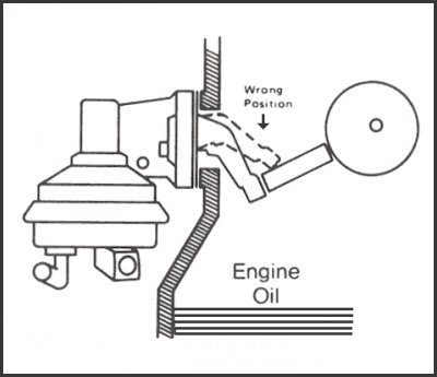

If the fuel pump corrects the problem and the lines are not leaking I would not change the fuel lines. If the pump doesn't fix it I would look for a collapsed fuel line on the suction side of the pump.
As for inside the filter, what you are looking for is black rubber particles that would show a deteriorating pump diaphragm or hoses.
As to the mystery wire, that is a condenser that was probably wired to the coil as a radio noise suppresser.

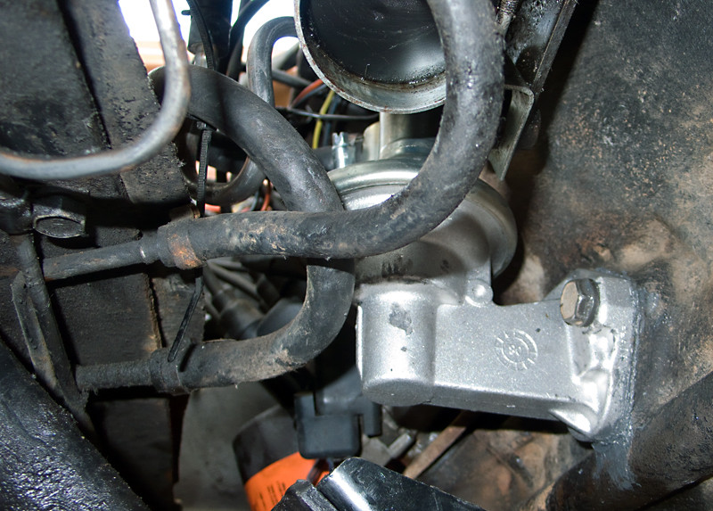

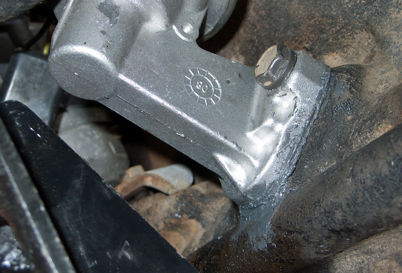

I replaced the fuel pump this weekend and with a little help of starter fluid for the first start it's been working great.
I've noticed that the engine doesn't idle really high immediately after startup (it used to always do this in the several months that I've owned the truck) and it also idles significantly lower in general. The dash cluster doesn't have a tachometer so I'm not sure what the RPMs the engine is running at during idle. I'll post a video of the engine idling to see if you guys think it's OK or too low.

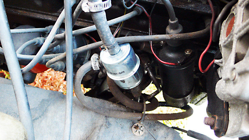

New fuel filter & pump in place:

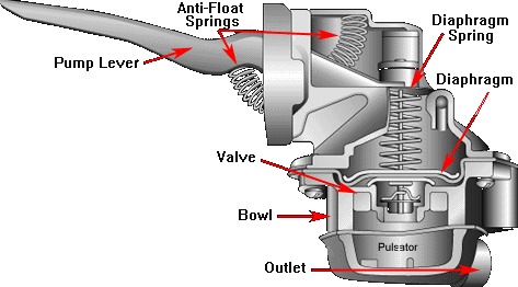

Helpful links:
How does an mechanical fuel pump work?
http://www.secondchancegarage.com/public/535.cfm
Mechanical fuel pump basics:
http://www.aa1car.com/library/fuel_pump_mechanical.htm
DIY Fuel Pump:
http://autorepair.about.com/cs/doity.../aa093000a.htm

Helpful links:
DIY Fuel Pump:
(this appears to be up-side-down compared to its position on the v6 block)
