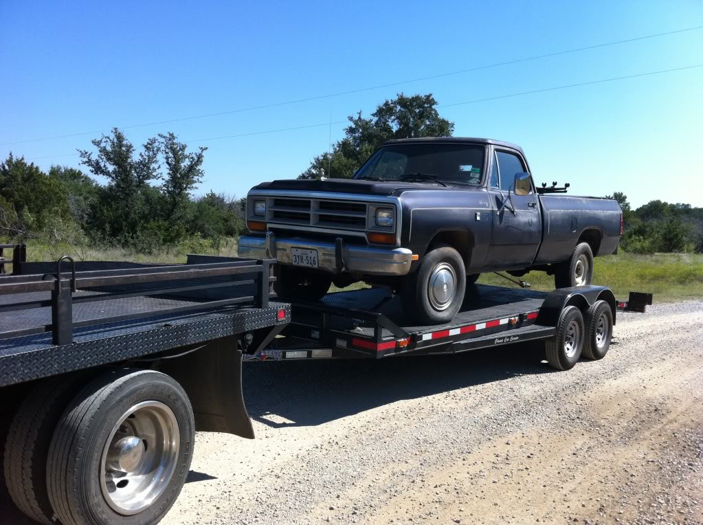

I have a 1985 dodge w250 4x4 pickup that a friend gave me for free. It ran last year but i am having a hard time getting the truck to fire. There is no fire coming to the spark plugs. It turns over just fine. This is what ive replaced so far : sparkplugs,sparkplug wires, coil, cap, rotor, and voltage regulator. All the wires look ok under the hood. What do yall think? This is the truck. Thanks.Name:  dodgepickup.jpg

Do you have power at the coil?
You should have dual pick-ups (start and run) in the distributor with 2 connectors with 2 wires to each connector. Unplug these connectors and check the resistance thru each pick-up coil. (150-900 ohms) You can check the air gaps on each coil with a NON-metalic feeler gauge.(start coil gap is 0.006 inch & run coil gap is 0.012 inch) DO NOT USE A STEEL FEELER GAUGE!!!!
The ignition module and the ballast resistor may also be suspect but one step at a time.
