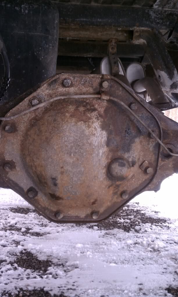

okay to answer question one, there are covers(pictures of down below) and for number 4 they are manual hubs. I would raise the truck, but I dont have any jacks that go high enough haha.
the tag on this says it has 3.23s in it
I cant make out what the tag says on this one.

So we know it is a 3.23 gear ratio. The 12 symmetrical bolts on the cover lead me to believe it is a Chrysler 9 1/4" rear differential. The front cover looks like a 10 bolt and the shape of the cover looks like a Dana 44 on the front.
