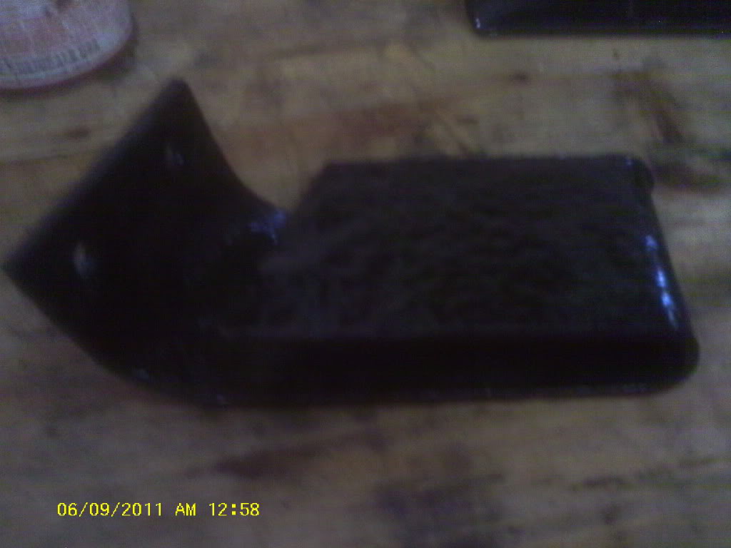

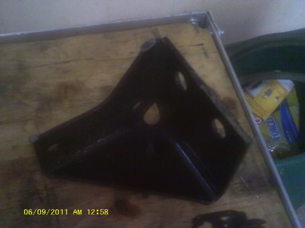

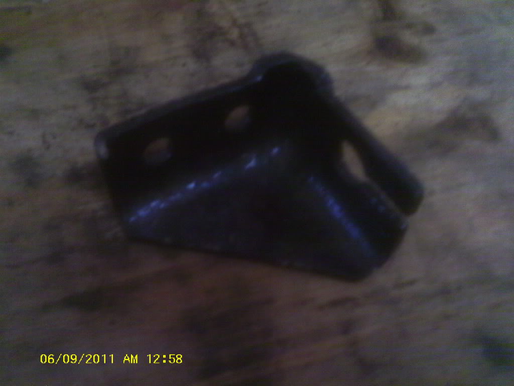

I remember painting them just don't remember where they came off from.

picture 2 and 3 look like they are for your park brake cable which would be drivers side frame and picture 1 might be for rear park brake cables. i'm not sure what those 2 plates in the last picture are for. i have never seen them when working on my trucks.

The first three are all for the parking brake cable. #2 is the forward most one. #3 comes next moving rearward. #1 is the rear most one about even with the rear tire. What size are the plates in #4?

Please correct me if I'm wrong, the first 3 pics are all for your park brake cables,
Pic #1, will mount on the bottom of your frame just in front of your rear tire on the pass. side, your 2 rear cables from the rear brakes will tuck inside this bracket to keep them from dragging on the ground.
Pic #2, is the front mount for the single park brake cable from your pedal before it splits into 2 cables, it will mount to the bottom of your frame somewhere under your pass. side door.
Pic #3, is the mount bracket for your 2 rear cables, it will mount in front of pic#1, your 2 rear cables will go through the holes you can see in the pictures and mount with a metal "horseshoe" clip.
