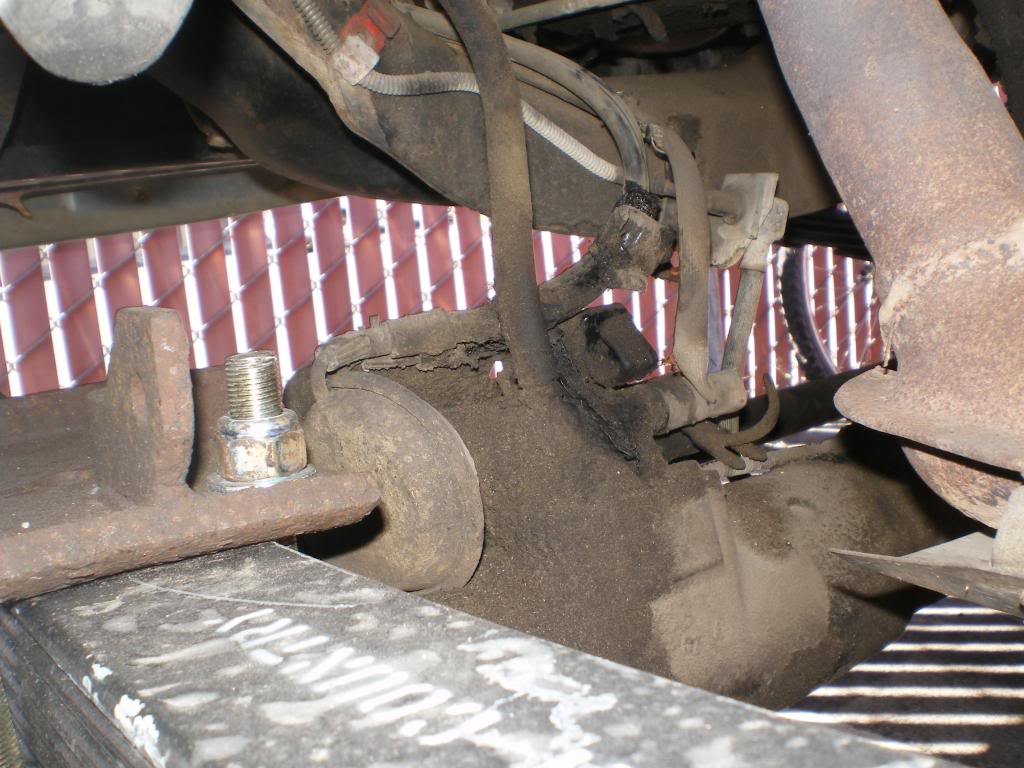

I agree with a front 44 and a rear 9.25 but is the front a regular 44 or a 44 with an axle disconnect. Take a picture of the axle tube at the drivers feet. Do you have a bolt on cap that covers the axle ends or is it a press fit smooth cap with no bolts?

it's a giant looking dust cap, like it will come off with big pair of channel locks.
get a picture in a few.

That is a press fit cap and it means you have a vacuum axle engagement system.
Old Oct 30, 2011 | 06:02 PM
SEAL's Avatar
SEAL
Posts: 2,639
From: Bent Mountain Va
To answer question 3.
Jack it up and remove the front wheel. Remove the 2 caliper bolts and hang the caliper up out of the way. I use an old screw driver and a small hammer to tap the cap loose. Remove the snap ring on the end of the axle. You will need a special socket to remove the two wheel bearing adjustment nuts. There is a retaining washer between them that must be removed before the second adjuster nut is removed. Note that there is a lock pin on the face of the inner adjuster nut. This pin must be facing out during reassembly. Pull the rotor and hub as an assembly and catch the outer bearing. Remove the inner grease seal and the inner bearing. The wheel studs can be punched out or pressed out and the rotor will separate from the hub. Clean everything and repack the bearings. Assembly is the reverse of removal but there is an adjustment procedure for the wheel bearing nut.
