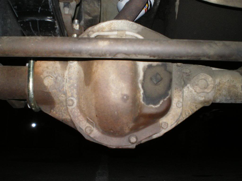

I'll try to get some pics of the front axle. Maybe someone can ID it.
What's a typical gear ratio for these 80's 4x4 trucks?

Your axles are a Dana 44 front and 9.25 rear.
The ratios could be 3.23, 3.55, or 3.90

Front Axle
Rear Axle
http://s223.photobucket.com/albums/d...dge%20W%20150/
