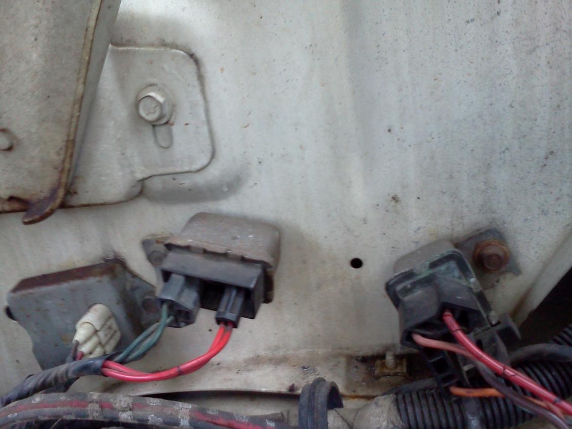

the new wire i put on the coil had an abnormally long connector plug so i push it as far as it will go in without trying to damage or break anything. in the picture i attached, the red connector was kinda disconnected and kept making a DONG noise (the left side of the picture). you can even see how it still looks like its barely up there. after pushing it all the way on, my battery was too weak to crank so im leaving it on the charger while i go to work. what is that do-hicky?

That do-hicky is a relay. Which one I am not sure. You can unplug it and see what happens. The symptoms will tell you which one it is. OR You can check the color of wires with a wiring diagram for your 85.
