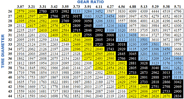

I don't know how much this helps but here's a general gear ratio chart:
With -
Yellow : Highway Driving, Good Fuel Economy
Black: Balanced, Daily Driver & Trail Use
Blue: Most Power and Towing, Reduced Fuel Economy
