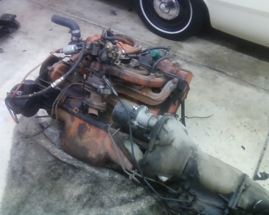

have you seen where the starter is on a slant six? if the truck is standard you could find a new bell housing but if it is auto you will most likely have to get the correct transmission

Starter looks the same to me... Also, I know for a fact that they use the same starter.

the starts are the same between pretty much every engine. it is more so where the starter is located. it sits where a cylinder head would be on a v8

Okay you are probably right. Sorry OP.
