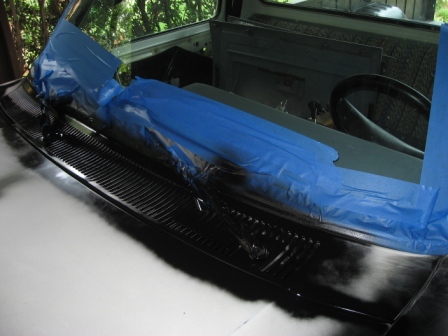

I decided to paint my truck myself with Rustoleum following the guidance on a few web sites. Originally the truck was white, now it is black. I used over 3 quarts of Glossy Black mixed equally with mineral spirits. Rolled on with 4" dense foam rollers. I wet sanded between coats with Meguiars 2500 grit and polished with Meguiars 105 and then Meguiars 205. I replaced the rear tail lights, door handles and front side amber lights with aftermarket replicas. I found new rubber gaskets for the door locks also. I wire brushed the inner door panels and sprayed them dark gray with vinyl paint. Overall I am pleased, it is not perfect, but at least they are my imperfections. Pictures are below.

After First Coat of Rustoleum:

How long it takes...less than an hour for each of the 8 coats to roll on. 45 minutes of wet sanding, but I did not start sanding until after the 4th coat, which might have been a coat or two late.
Prep time though was maybe 10 hours. I had a local body shop fix two dents and straigten the bumper for less than $400. I wet sanded lots of minor rust scratches and used a wire brush on my Milwaukee grinder on some others. I filled a couple of dozen bolt holes in the bed that were used to attach some metal rails to the bed. Within the past year I used POR15's Prep and Ready rust killer and put on a coat of POR15 paint in a few spots, to include the tailgate that was brownish with rust and along and under the door's rubber trim.
I also replaced most of the rubber seals along the doors and windows, but not the triangular vent window. Two hours for this.
It also took me a couple of hours to meticulously tape the windows, wipers, grill (I could not unscrew the grill screws), remove the door handles, lock cylinders and logos.
I used Rustoleum spray paint primer for some spot priming, Rustoleum spray truck bed paint for the bed and Rustoelum Auto Glossy Black for tough spots and nooks and crannies.
I noticed your truck has the "DODGE RAM" across the tailgate. There is a company that sells these in Black, White and Gold. Mine had this too, but sanded it off and just painted it black. You can find the company on Ebay. I think his listed measurements might be off, but you can send him a "rubbing" to make sure you get the right decal. http://www.ebay.com/itm/1981-93-DODG...5281bc&vxp=mtr
After the 8th coat of paint I let it sit for a day or two and meticulously removed the tape -- with tweezers for some of it. Where the tape pulled up black paint, I went back with a paint brush used for painting models and repaired the missing paint. Now, you should let it sit in the sun to "bake" and cure for a few days. Or, go on vacation and leave it alone, which is what I did.
I painted the door jams too, which was another 3 hours. I washed them down with Simple Green and the orange degreasser and lightly sanded the original paint and hit it with two coats of the 50/50 rusolteum. I have a few spots that need to be hit again.
I did the same with the rims, I left them on and hit them with two coats. I did not do the center of the wheel, the hub caps covers them. Some day I will take off the wheels and spray the rest. I did not want to get paint on the bolts or nuts.
After the paint cured in the sun for a few days, I lightly wet sanded it with Meguiars 2500 grit and polished with Meguiars 105 and then Meguiars 205. Figure 2 hours for each of these steps.
