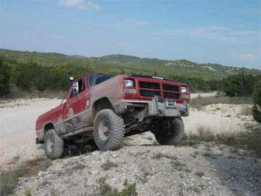

have you seen SixGun's truck? you can get a fair bit of lift out of stock 2wd parts. you just need better springs that will not settle as much as the stock ones. he has a 2" suspension lift and 3" body lift and it looks mean with 33's

I've seen it, but I didn't realize he was running stock control arms.
