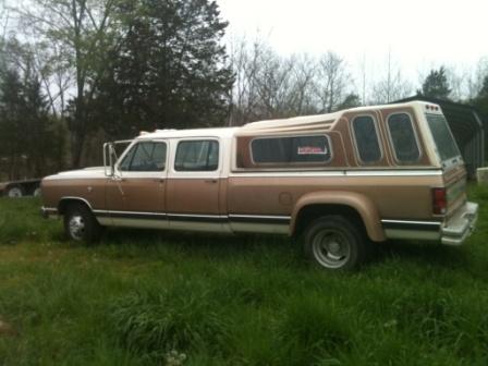

I am looking into the reasonable feasibility of swapping a complete Cummins 5.9 and Allison 6spd into my 1985 D350, replacing my gasser 360.
I have about $4K into the D350 (6 pack cab, dually, 2WD) as it sets and I am using it to pull heavy box trailers. I averaged 7.5 MPG this last trip towing fully loaded trailer and truck.
The 360 in it runs strong and pulls fine, but it certainly knows it has a load. The TF727 in it seems to be doing fine so far on the 750 mile round trip through Missouri hills and turns I just got back from.
An opportunity to purchase a Cummins 5.9 (only 108K miles) and Allison 6spd has been presented to me. It includes the complete wiring harness and push button tranny control. They only want $3K for it all. It came out of a School Bus setup, the bus was totaled due to frame damage from the rear when some vandals pushed it backwards down a hill into concrete pillars. The guy bought it to put into a Chevy, but soon found it wasn't heavy duty enough to handle the extra weight and I believe there were some clearance issues inside the frame.
I am soliciting some realistic feedback on whether or not this would be a worthwhile swap. Would I see any real mileage savings? I get 7.5 now.
My fuzzy math (7.5 MPG vs. 12 MPG) says it would take me ~16K miles to recoup the initial investment, not including all the extras needed to complete the transplant.
Someone talk me off the roof or onto it...LOL...
