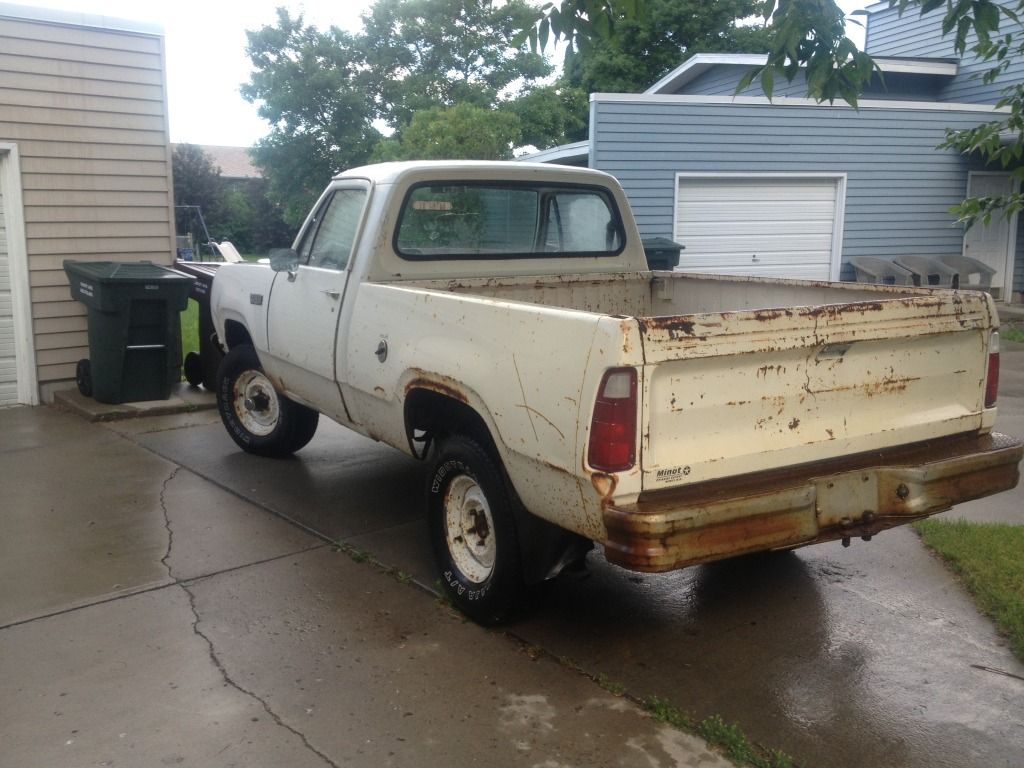

Just picked up a new to me 1980 dodge ram power wagon w150. Has a 318 and a 3sp with overdrive. Has about a 3" lift I think. Have several questions
The speedometer is very funky. It will get stuck in random places on the gauge. Will this require a new speedo or cable or both? Where is the cable attached to the trans?
It has an aftermarket radio shoved into the dash to the right of the steering wheel. It's not bolted done or anything. Is there a bracket that I can install to mount the radio?
What are some common upgrades to get more power?
Intake mani and 4bbl carb? How much power does an intake and carb swap make? Anything else?
