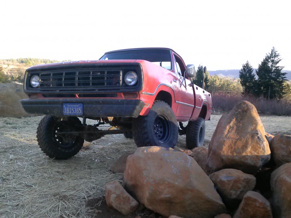

hey guys! i finally finished putting the lift kit on my truck and im really happy with how it came out.. it took me about a week to put it on in my barn just using jack stands and stuff. it somebody on here recommended the rough country lift kit for a 75 power wagon and they where right. it looks SICK!
I have a lot of things left to do on the truck. there are some simple things like i want to redo the brakes. i have some small wiring stuff and some stuff i cant figure out. if you guys can help me that would be great!
the first thing is the turn signals. they dont work at all.. i put a new cam in the steering column but that didnt fix it. im going to check the fuses soon, but would you guys recommend anything else.
and the other thing is my truck used to handle pretty bad before the lift kit. now that it has a lift it feels like it sways freely all over the road and its kinda scary to drive. i just put dual steering stabilizers on tonight but didnt have any time to test them. that should help a bit, but would you guys recommend doing anything else... btw when i hit about 60 on the freeway the whole truck starts to vibrate... and im not too sure why.
