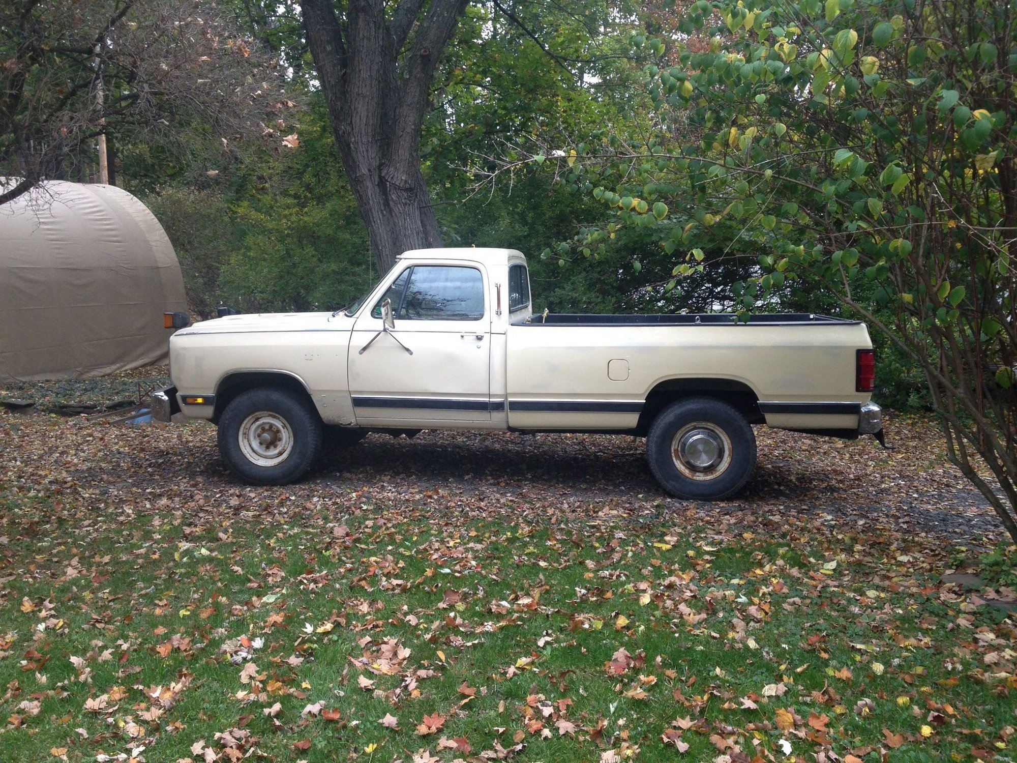

nice truck by the way. im hoping to get an 91 cummins this spring as well to add to my collection, well its more show truck quality if anything lol
looks very similar to this

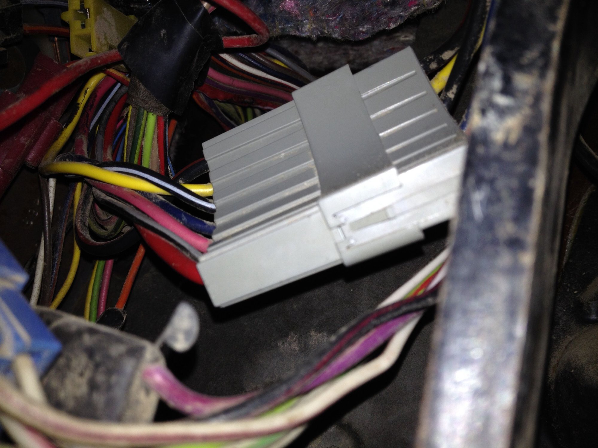

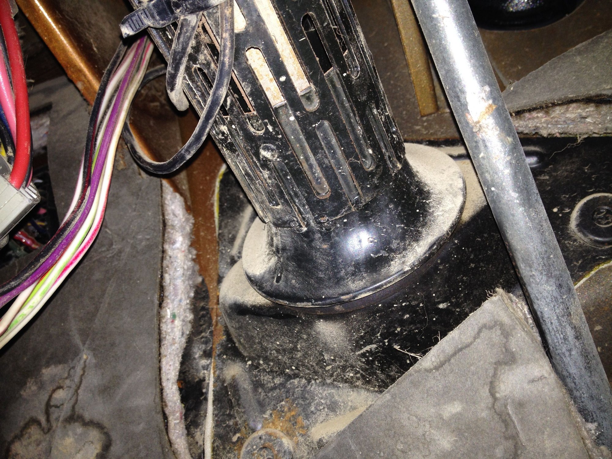

Default Photos
The steering wheel needs to be removed to take off the steering column cover.
Bottom of steering column.
Plug for ignition switch behind the fuse box.

the plug in the third pic: if you follow the wiring to the switch that is bolted to the column you will find the switch I was referring to WITH the rod attached to the top of it.
you got a pic of the side of the column with the turn signal lever on it?
