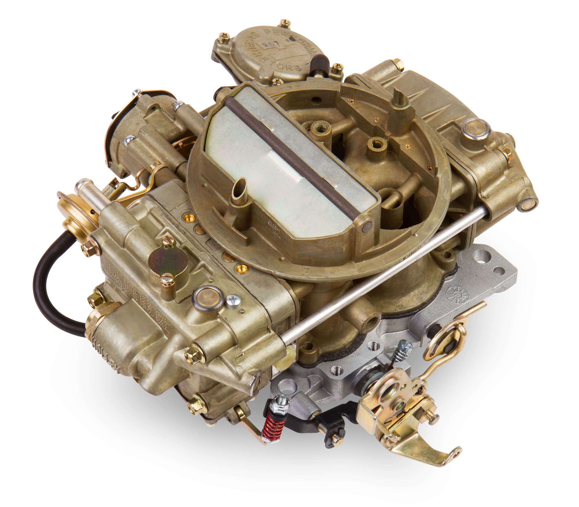

Old Jul 7, 2018 | 10:26 AM
Moparite's Avatar
Moparite
Joined: Feb 2015
Posts: 7,435
Likes: 578
This...
Plus this...
Equals this...
I'm not a fan of the aftermarket efi systems. If the price was less then $500 then maybe. Holley carbs are the simplest to use and run well straight out of the box. Only two adjusting screws!
