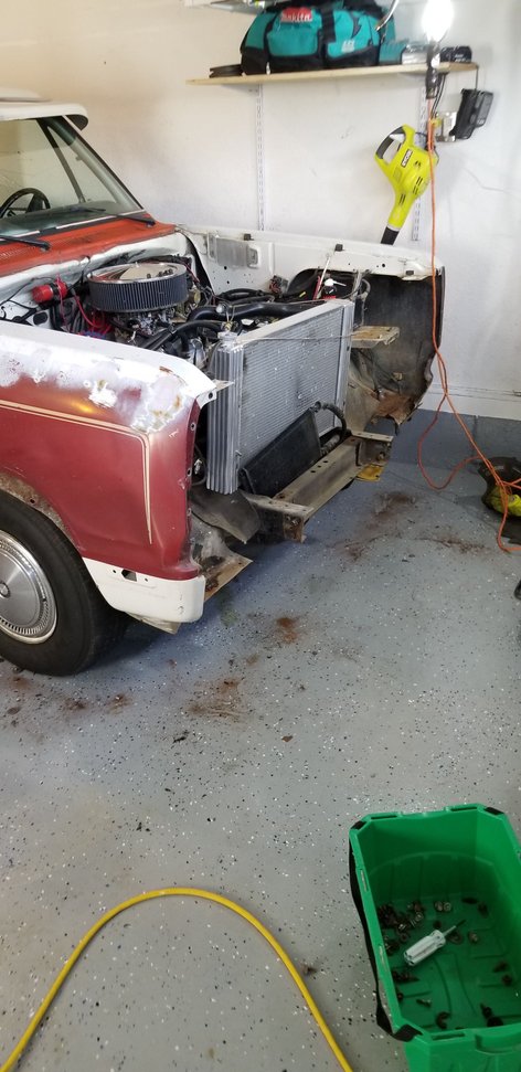

1985 with a 1979 core support and grill
Core support

Old Oct 3, 2018 | 01:57 PM

Default Pre swap
Pre swap

Old Oct 3, 2018 | 03:10 PM
Noelie84's Avatar
Noelie84
Joined: Apr 2014
Posts: 88
Core support
Did you have to tweak the radiator support to make it work? I thought that the 70's version had different connection points to the fenders than the 80's version.

Old Oct 3, 2018 | 03:18 PM
Dale Plante's Avatar
Dale Plante
Joined: Sep 2018
Posts: 5
Default Fender holes line up
The old 80's head lights bezels are longer then the tin grills of the 70's so there is a small body line and hole from where the square bezels should be.
I will be getting 70's quarter panels and mig welding in the the 80's wheel arches onto them
