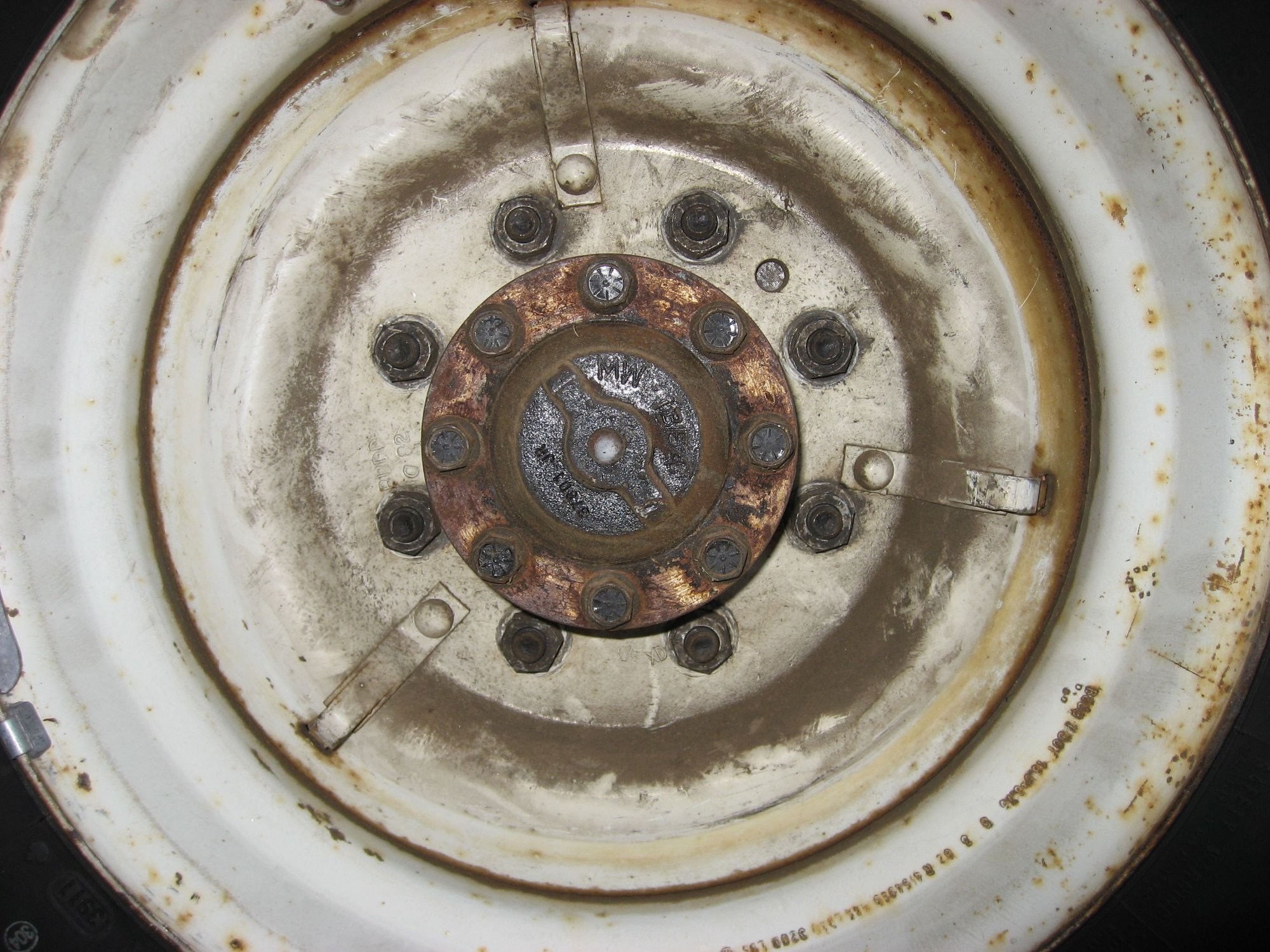

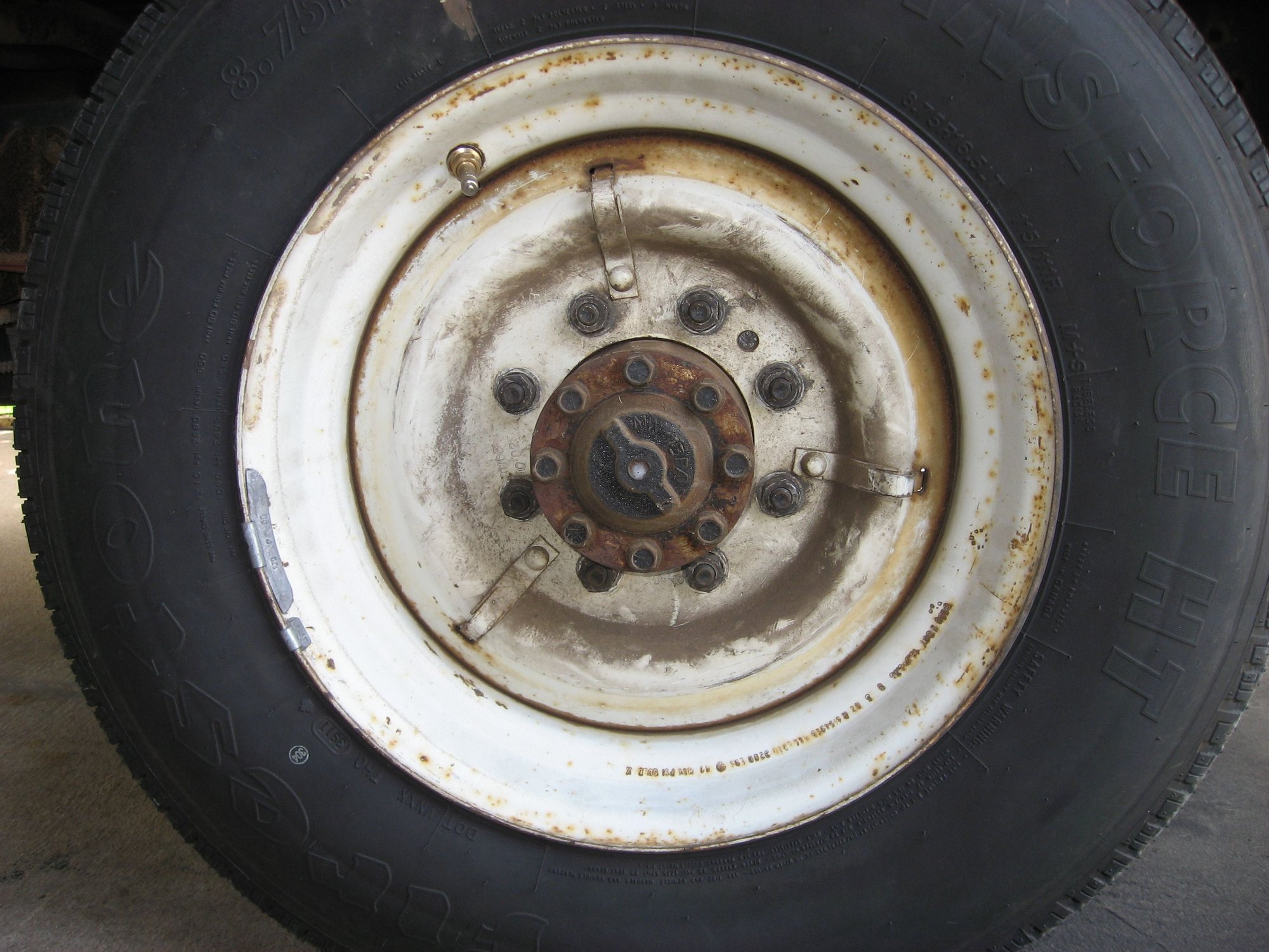

My 1982 D350 one ton truck has 16.5" x 6.75" wheels and I would like to change the wheels to 16". Has anyone switched from the annoyingly difficult and rare 16.5" wheels to 16"? What were your lessons learned and what wheels did you select? Did the hub need to be changed?
Thanks!
Pumbu

As long the bolt pattern remains the same no problem.You can even go up in diam like to 17 or 20.Just stay in the bolt pattern.Just a thought.................................

Most 8 lug 16" wheels will fit. I scored some chrome factory wheels at a junk yard years ago for my 72 W200.
