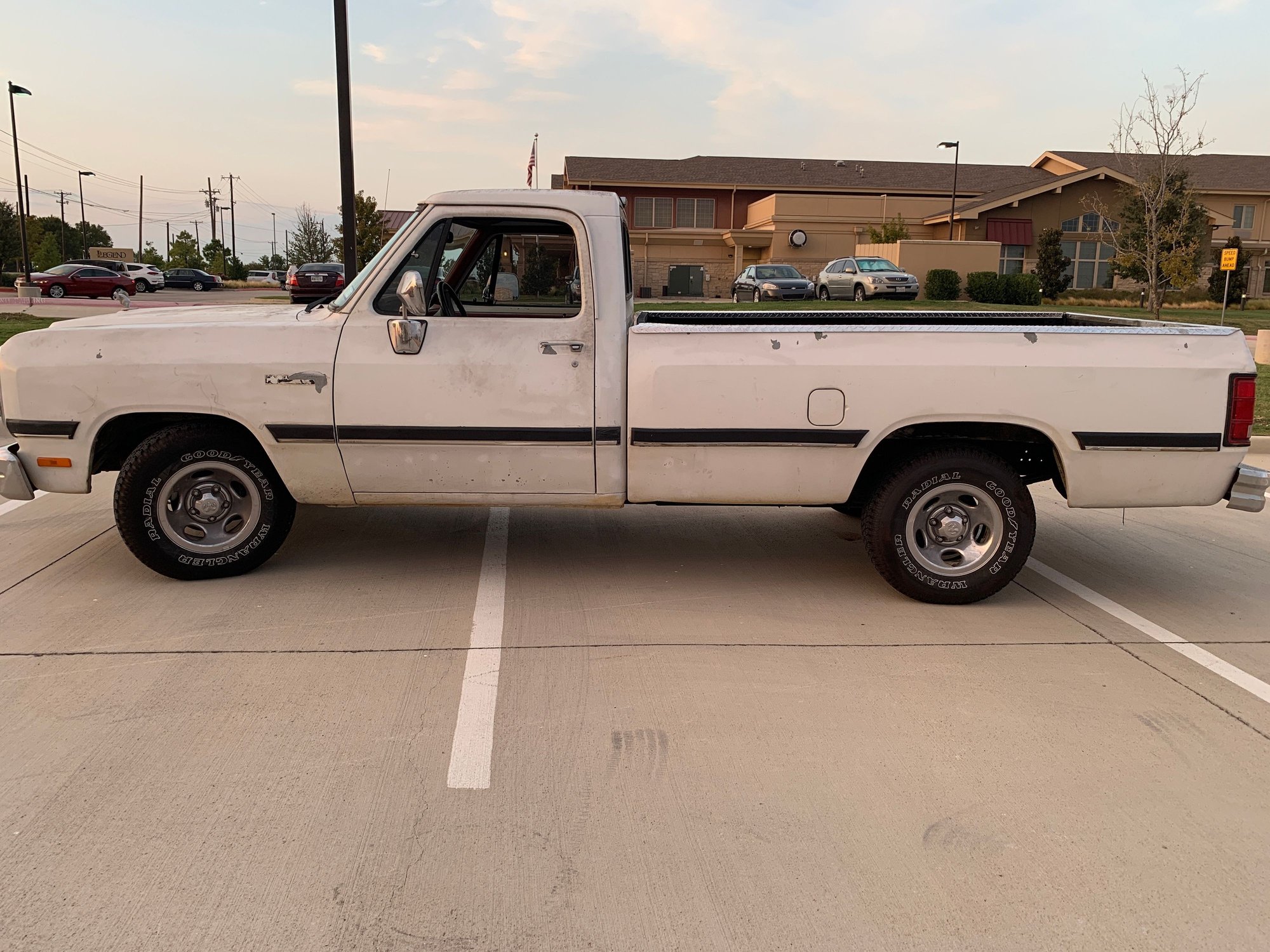

I’ve been looking absolutely everywhere to find a way to lift the truck up a bit higher than its current stock ride height. Because the front end is lower, if I wanted to raise the entire truck up 2 inches, I’d have to level the already 2 inch lower front end up, then some more. Leaving me looking for a 4x2 lift, but I’ve also heard stories of control arms rubbing if the front end is lifted higher than 2 inches on these 2wd trucks. The truck looks overall very small and wimpy and I hate seeing it this way. If anyone could please help me find some parts to lift my 91 D150 I’d be in their debt. Picture provided below.

@SixGun has a lifted 2wd. 2 inch suspension lift is max for the front. anything more than that and you got to do a body lift or custom fabbing suspension parts to lift it.
https://dodgeforum.com/forum/1st-gen...n-91-d150.html
