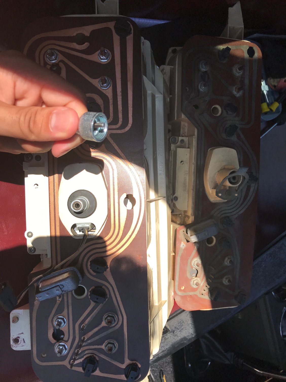

Thank you, I can see that the instrument cluster I bought from the junkyard has the clip type on the back of it but the one that was in my truck when I bought it doesn’t. The cable that was in my truck has a nut on the cable that wants to be threaded onto something but that something is missing. Photos for reference.
Instrument cluster that was in my truck on bottom- one I got out of junkyard on top. New cable I bought in photo as well

Hmmm...I wonder if it will slide in and the metal tab will hold it in place. I've worked on so many different years in my life, I have trouble keeping track but I seem to remember something like the clip on a threaded connection. Keep in mind I've had Dodge and other Mopars from 1948 to 2003 models.
no I’ve tried the metal clip one. Nothing holds this cable in place. It’s very obvious either the cable is the wrong cable or there’s something missing from the instrument cluster that allows the cable to thread in. The one with the clip is from the junkyard and is an 83’.
See if you can find one from 1986 or a little later. Ma Mopar changed a lot of little details on these truck while they designed the '94 models,

I'm way late on a reply to this 6 month old thread but if it helps, the end of the cable you're holding in your hand connects to an electronic signal generator that mounts near the frame rail. There is another cable that goes from the signal generator to the speedo head in the dash. The end that connects to the speedo head has a plastic end on it that snaps onto the speedo head to lock it on. Theres a tab that you press to release it. The signal generator sends a speed signal to the EST computer behind the battery. That's the way my 86 d150 is set up. If you don't use the EST computer anymore then you should be able to get a cable from an older model that didn't have the signal generator to work. I looked on Napa's website and they show part # 6151660 as a 1 piece cable option which is 80" long. It has the correct looking ends on it. They only show the lower piece available if you have the 2 piece cable.

I ended up using a washer to secure the seal around the inside of the threading lol. It’s a bo jank fix but 6 months later the speedometer still reads accurately!
