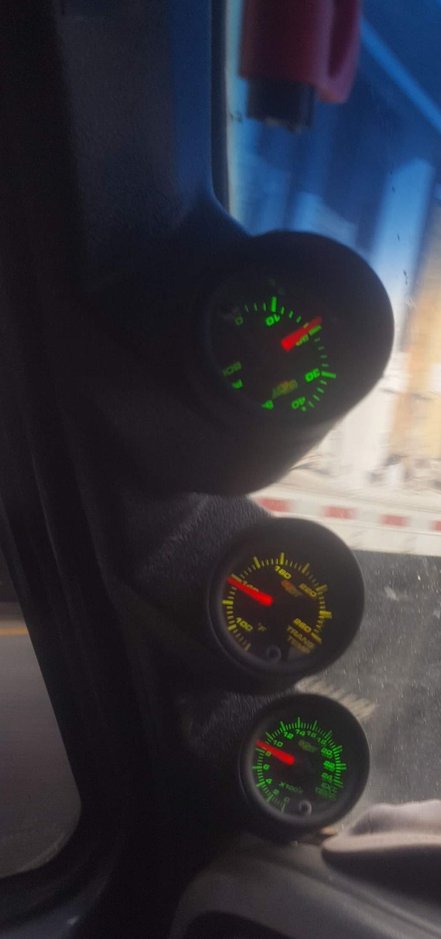

If you are modifing it to make anymore power than stock then you should have EGT, boost, and trans temp gauges, even if you are just turning the injection pump up. A tachometer is a good idea also if you don't have one.

this is they gauge setup my friend has in his little truck. not a huge fan of it. i like the 3 in 1 gauge that his big truck has but this does the job. yes the boost gauge is in pretty much upside down but that is so you can actually see what is is doing. should have probably put trans or EGT gauge in the top hole since they have a larger gauge sweep before you are in trouble but we didn't think of that when we put it in. can't wait to see the boost gauge saying 25-30 once all the leaks on the little truck get fixed.
