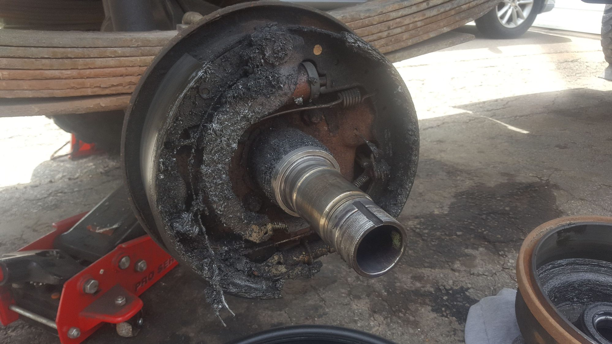

have you checked to make sure your rear brakes adjusted and where did the brake fluid go? dealt with something similar on my friends 91w250 a couple months ago. wheel cylinder failed destroying the new 3" shoes that were installed only a couple years prior. did you make sure to bleed the right rear first? also when possible i generally like to let gravity do most of the work. leave the bleeder open till you start getting fluid out of it. i would recommend doing it this way. you need the line to go up so the air can travel up but the line can stay filled with fluid.
