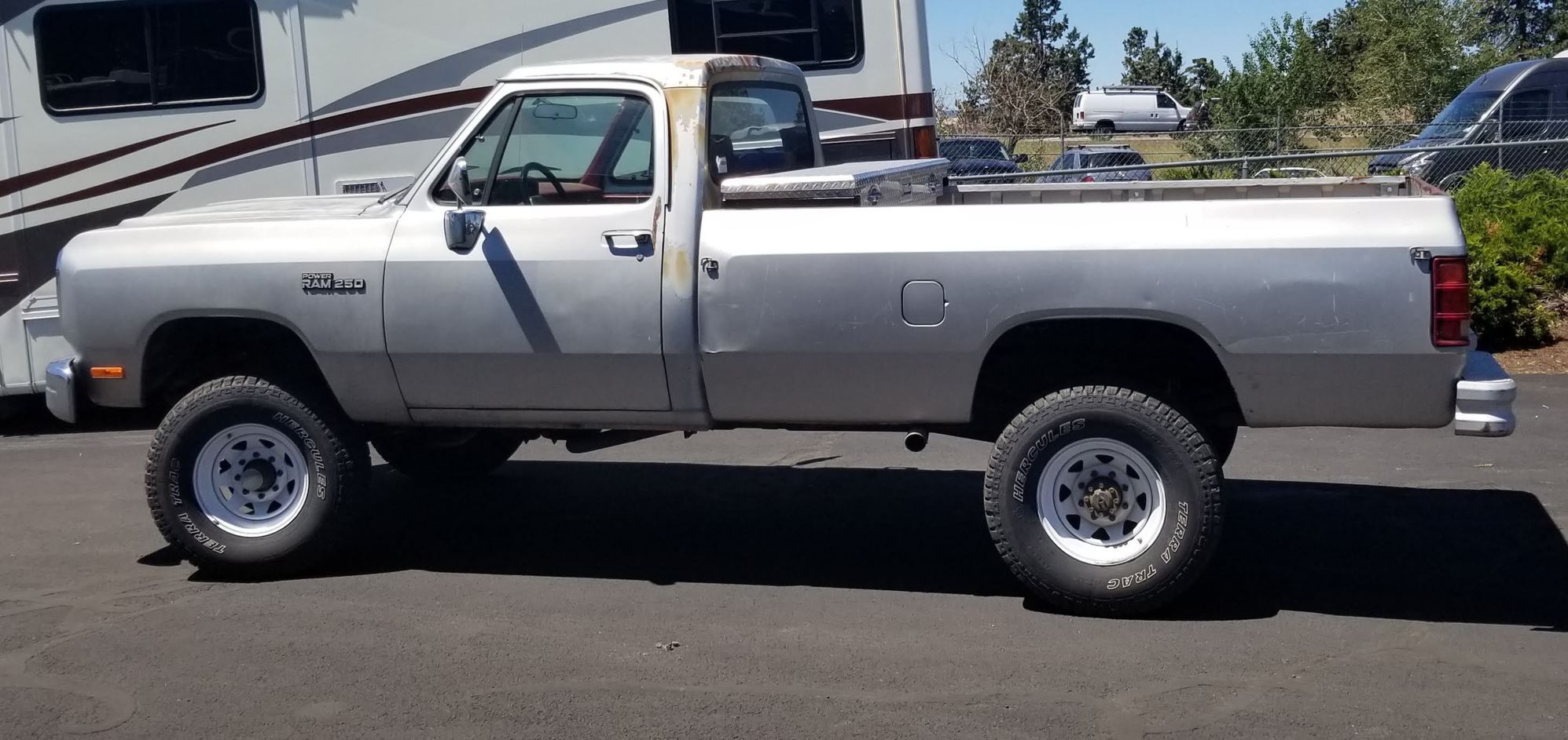

For acceleration! It has Long tube Hooker Headers and thrush turbo exhaust and a EGR delete.
1991 W250 360TBI V8
