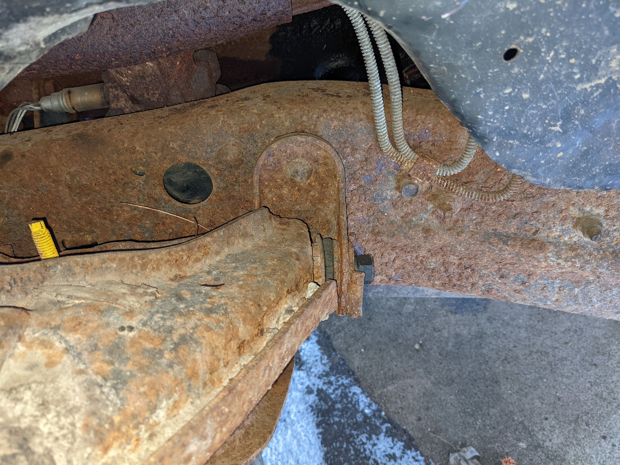

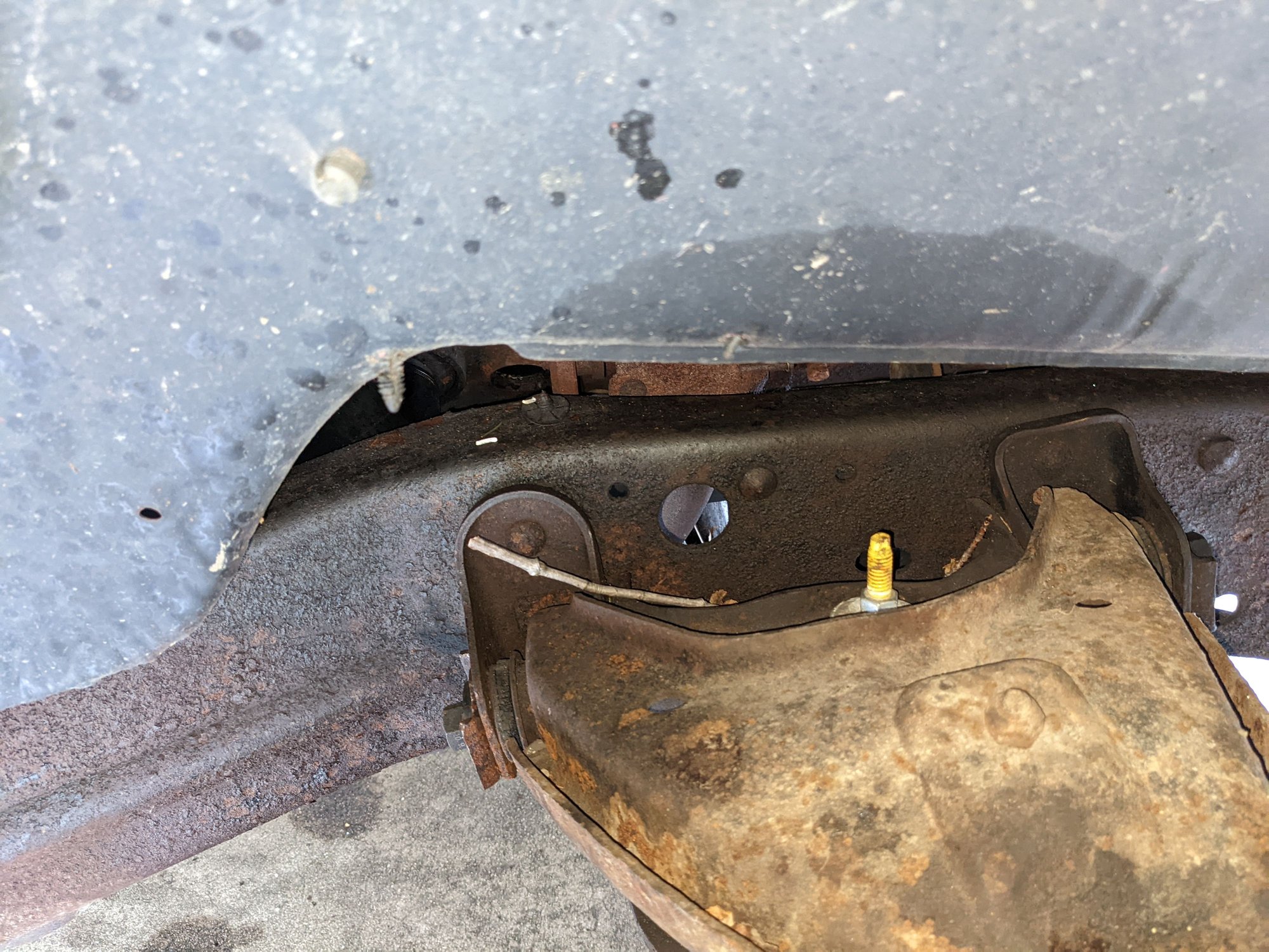

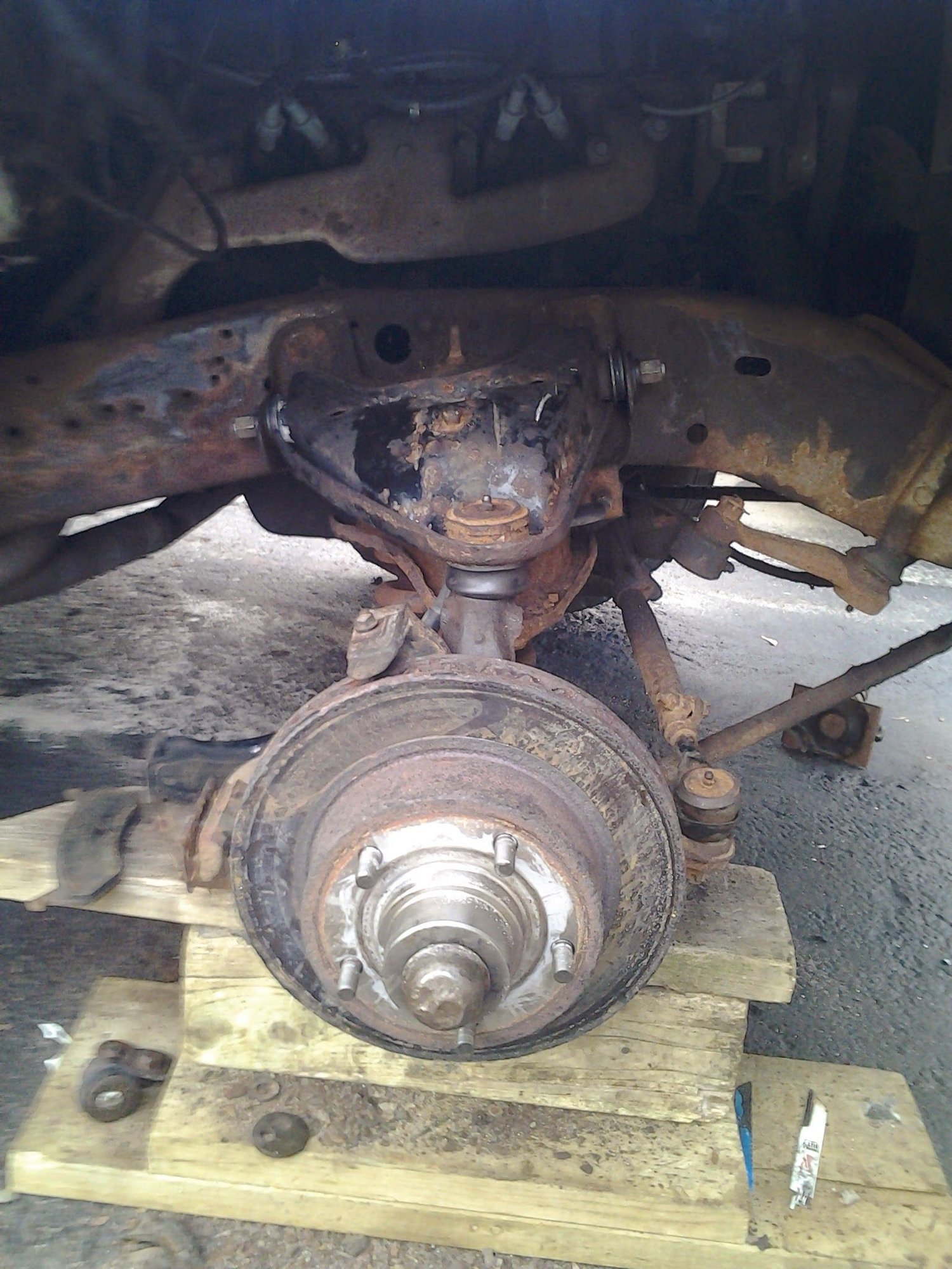

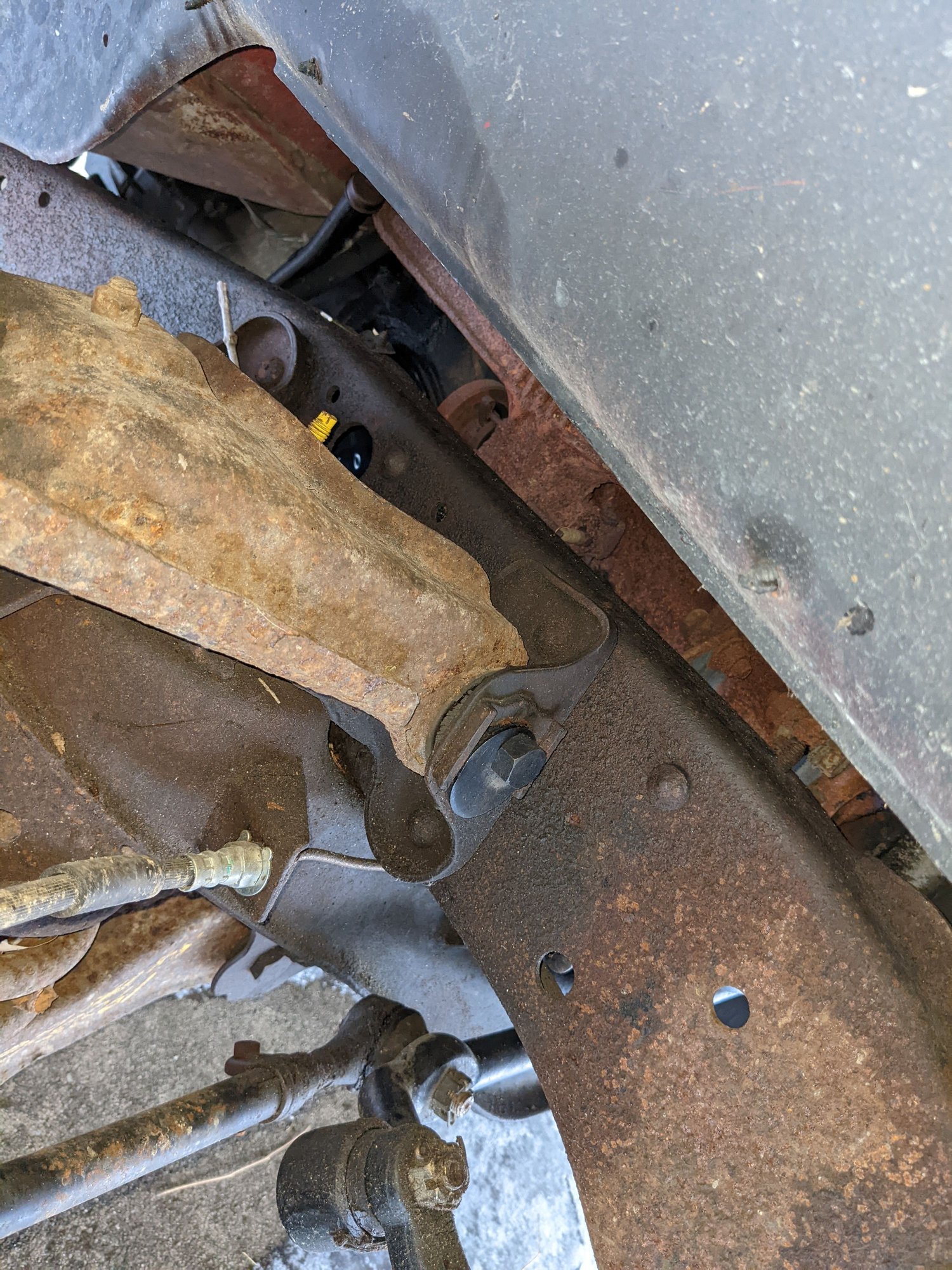

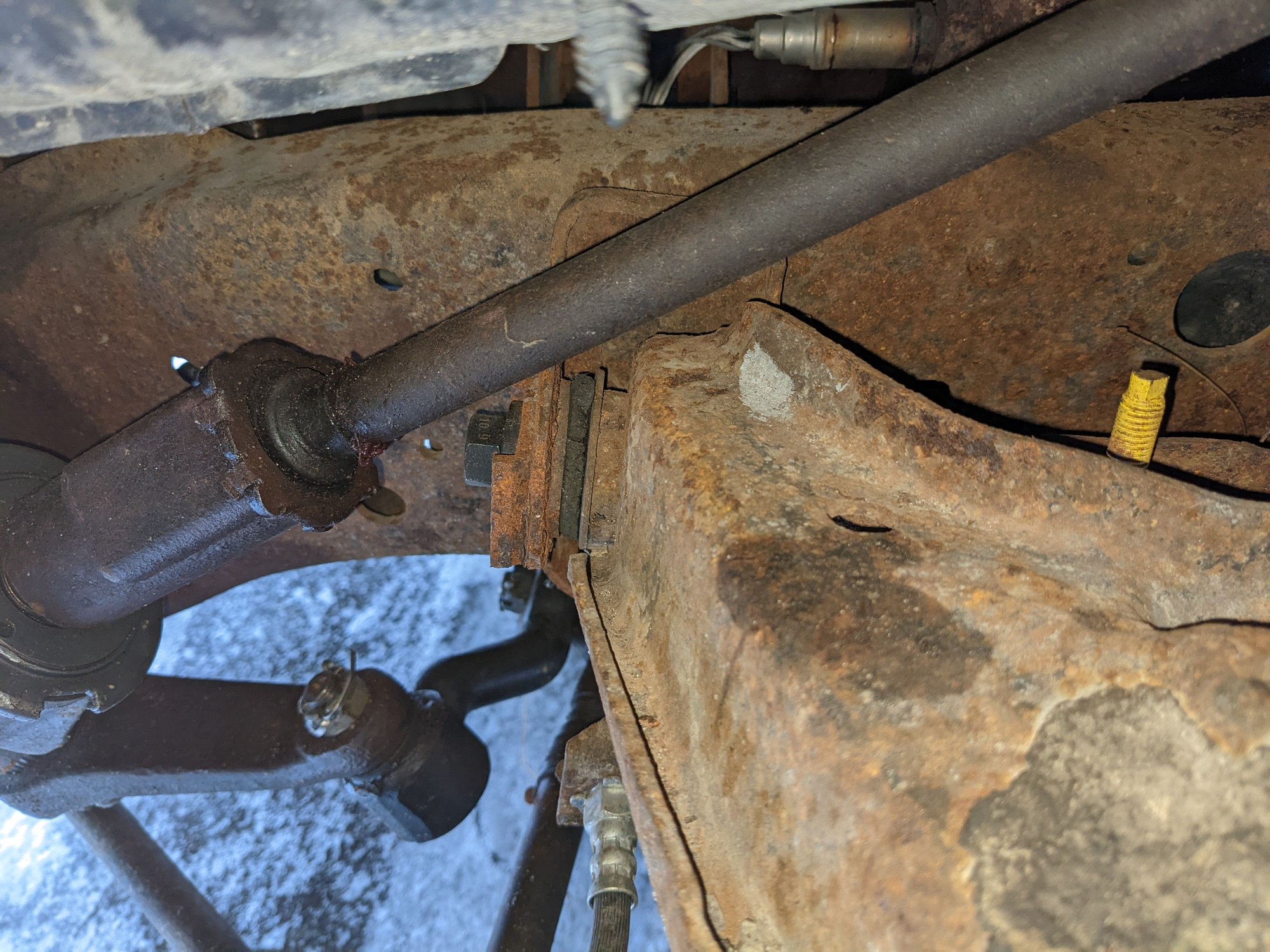

Unfortunately my truck is packed away for the winter so I cannot get better pictures than these.

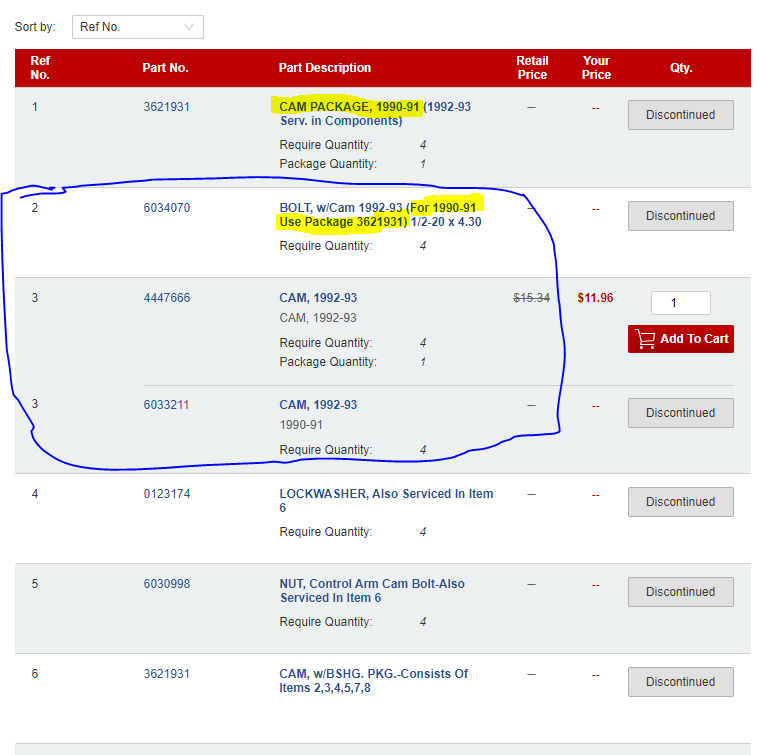

I did extensive research and was able to maybe find the source of the woes, according to one of the mopar parts websites which has the diagram of the control arm, the 1990-1991 trucks utilize a different part number for the cam bolt kits (as ref no. 1) than the 1992-1993 (ref no. 2). However they are all listed under fitting 1990-1993 trucks (the years for the diagram), the cam bolts are also not separately listed as replicable parts numbers for the 1990-1991 trucks, only 1992-1993 (as shown by ref no. 3 which are cam bolts only). The only way this is recognizable is if you read the descriptions, otherwise the part numbers are listed as fitting 1990-1993.
I see on your profile you have a 1993, perhaps this is why they worked on your truck? I do have the original bolts and they measure to 5" and found one listing for NOS on the part number 3621931 and they look identical to the ones removed from my truck. Do you have a measurement on either your original bolts or the replacements you've used?
